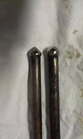

My push rods for the 1:st cylinder..
The left one wich is the intake looks as a moskeé and is probably worn out, or??
And the right one is the outlet, rest of them looked as the right one.
The 430 has been a bit lazy, i promise you that, because the intake hasn't opened for quite a while...
Any ideas somebody, how that has happened??

Hard to tell what the problem was. Metallury, wrong lifter pre load, wrong length of the push rod, rocker arm failure....etc.
Make sure to replace the push rod together with the rocker arm as well. Check for proper length and pre load.

Looks like the push rod in question was starving from insufficient oil supply. See its' dark blueish coloration beneath the tip. This possible cause would explain the tipp's abrasion.
Make sure to disassemble the rocker arm shafts and flush clean everything. The shafts can accumulate a lot of grime that can block oil flow to the rocker arms.

That sounds like a probable reason because the rocker arms on the 1:st cylinder and the valve springs were covered with a sticky mass, however i'm gonna replace as most parts as possible with new ones, mayby even the rocker shaft if it is worn out...
