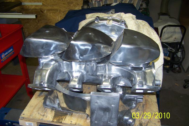

Here are my Nicson marine flame arrestors, and the intake and some other stuff that is/has/continues to be polished :mrgreen:
The nicsons are going to require a spacer to stretch them out some, given how close the 2300's are to each other. I am going to make a wooden pattern and have the spacer cast in aluminum, then machine the ends to hold the arrestor and bolt to the carb.

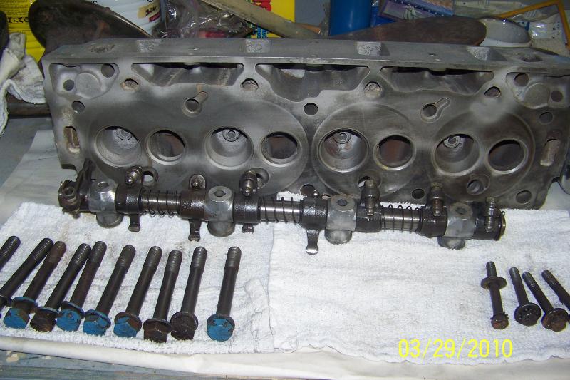

Heads have been bead blasted, disassembled, rockers cleaned and reassembled, ready for machine work. New guides, new intake seats, new stem seals, springs will be checked.
