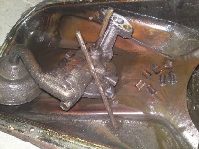

Here's what happened yesterday to Tom, my latest fellow slabside owner in Holland, when he was test driving his recently acquired '64:
I had warned him about this but he nor I expected it to happen on the first outing.
So.... to everyone concerned: MEL 430 & MEL 462 motors were originally equipped with a cam timing gear that has nylon teeth and aluminium centre. They used these for quiet engine operation. The concern was quality off assembly, not longevity once out of warranty. It should have been replaced decades ago. If yours hasn't... do it now. If you're uncertain whether it has... do it now. Age alone will have caused the nylon teeth to become brittle and subject to breaking off, ending up in the oil pan and clogging the oil pickup screen, thereby choking off the oil pump (a fatal blow to any engine). You can see the teeth lying next to the oil pump in the photo.
Also, replace your original oil pump drive shaft with this billet drive shaft from Precision Oil Pumps in Ca, (559)325-3553. The original is literally as thin as a pencil and really isn't up to the job. This replacement works for the MEL engines. It is an FE drive that is +.0375" Longer for Main Girdle Applications. This shaft is about .075 too long, but the MEL guys get them and grind that amount off the bottom (pump end) to make them fit. Just use a bench grinder. The shafts are $20.00 plus shipping.

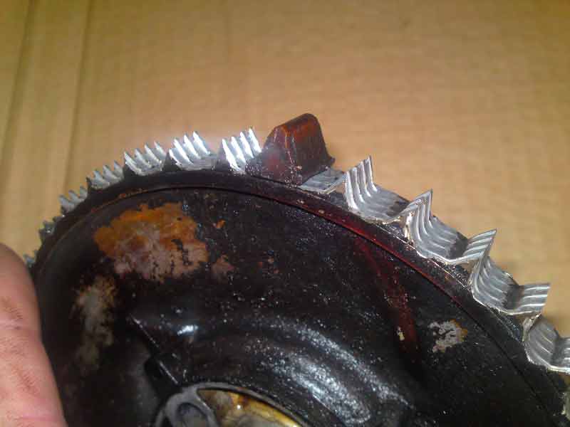

Tom is back to work on his motor. Here´s what he found; the cam timing gear had one tooth left:

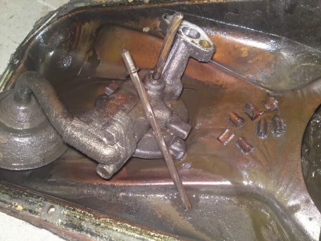

Lots of slack on the timing chain of course:
In the top right corner you can see one of the block thermostats. I told Tom to check for these and remove them if they were there. I didn't expect him to find them as I thought they weren't used after 1963 and his car is 1964.
Another sign that this '64 hasn't had a lot of love, is the missing main thermostat. Good thing Tom wants to do thing properly or not at all.
