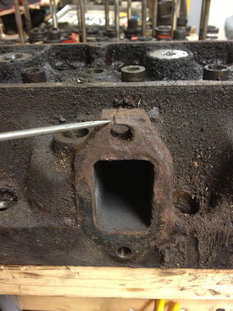

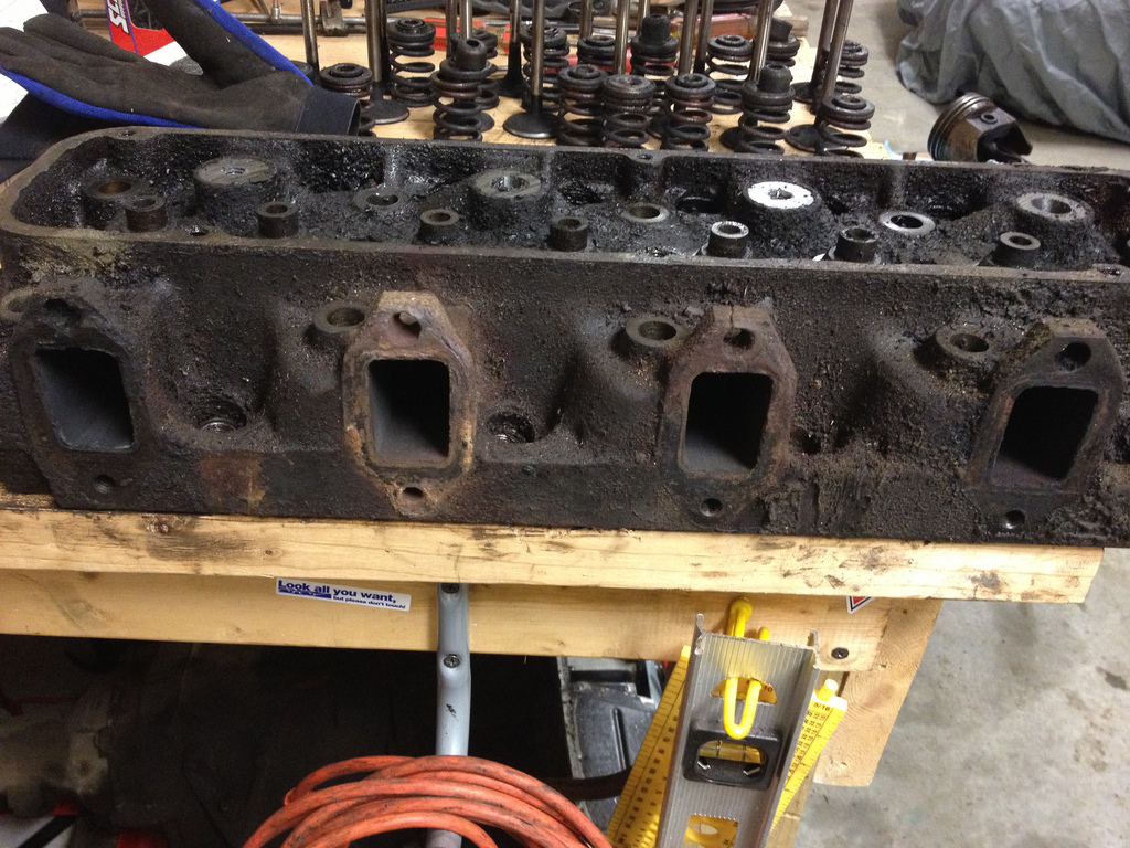

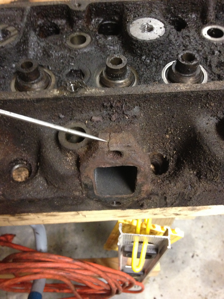

Okay, I finally was able to get to my shop and get some better pictures of the heads.
Here's the pic of the crack from the top: From the front: It looks like the whole surface will need to be built up in some spots and resurfaced: Going to try to take the heads to a machine shop tomorrow. I decided to get a new set of springs and valves. I brought along couple examples that weren't bent or mushroomed. I'm hoping they'll be able to find a set that matches.
Re: Tips for sending heads to the machine shop?
The crack shouldn't be a big issiue. If space allows you might try to support the bolt w. a nut from the backside of the ex. surface.
