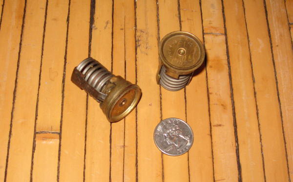

You mean the two water diverters and the two little bronze block thermostats that are behind either end of the water pump? To be sure, they are two different parts. The water diverters divert the flow of coolant to the cylinder heads. The (two little bronze block) thermostats regulate when the coolant starts to flow. Copied form a post by KULTULZ:
What these thermostats were designed to do was to allow coolant to more quickly heat around the cylinder barrels (no flow) and as it heated, the block thermostats would open allowing that heated coolant to flow into the rear of the intake manifold. The divertors supplied directed coolant flow until the thermostats opened.
The MEL was designed without an exhaust heat riser valve (exhaust heat under the intake manifold carb plenum) and was heated by coolant.
As the design progressed, LINC went to a coolant operated choke and finally an exhaust heat operated choke, negating the need of the special cooling system thermostats.
They were dropped by 1963 I've read. Not sure if it's the same with your year motor, but for the MEL 430 used in the '61-'65 Continental it is now advised to remove and not replace the two little bronze block thermostats. The diverters you do need. They're around $90 for the 430 & 462 at Lincoln Land and Baker's Auto (pressed brass or copper I believe). The mechanic who rebuilt my 462 made a set out of old pieces of steel tubing.

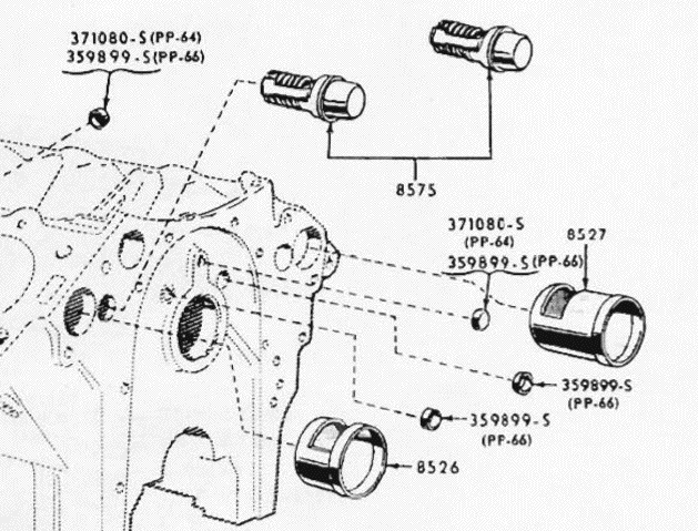

This is late but very important. The diverters must be installed as per the manual illustration (there will be an open coolant passage directly above that feeds the head(s)). This ensures constant coolant flow to the cylinder heads and intake manifold. The openings left by the removal of the block thermostats directs coolant flow directly to and around the cylinder barrels, thereby negating the needed flow to the cylinder heads.
This is a very specialized design and must not be compromised.
