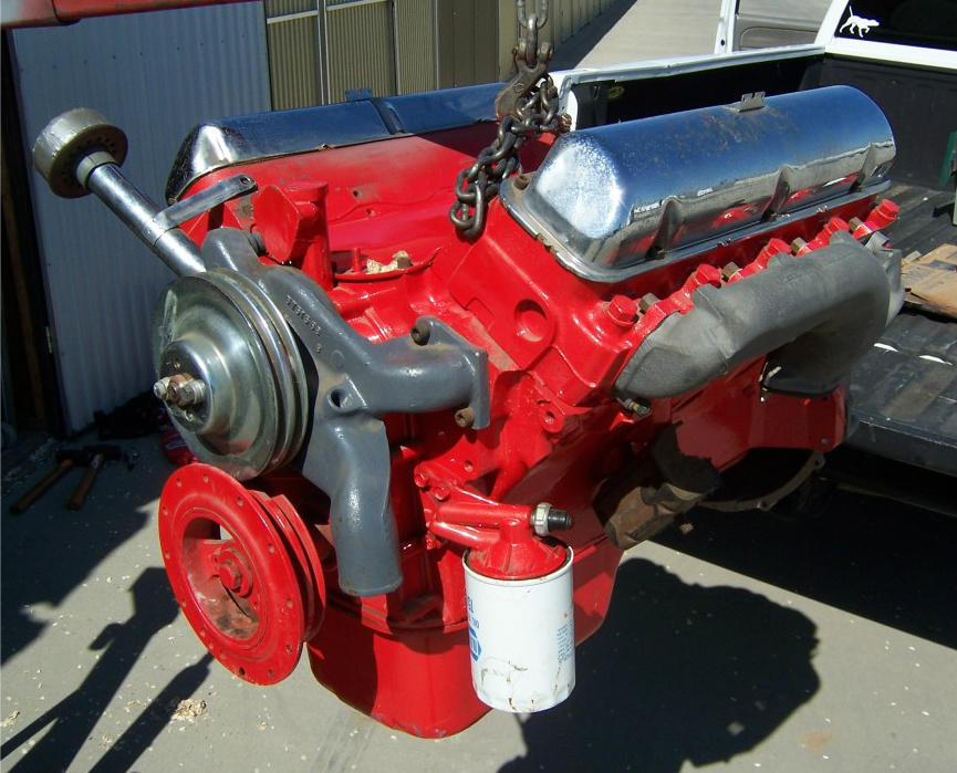

I just joined the MEL forum after lurking for some time. My newest acquisition pushed me to register and become an active part of this archive.
Take a peek.
I had trouble finding the block casting number in the records here and I cannot seem to remember exactly what mine was "8B... something" - a very odd number I thought.
but when I looked at the heads I found the familiar Ford casting/date number "B9M..." So i have 59 heads and I'm guessing a late 58 block.

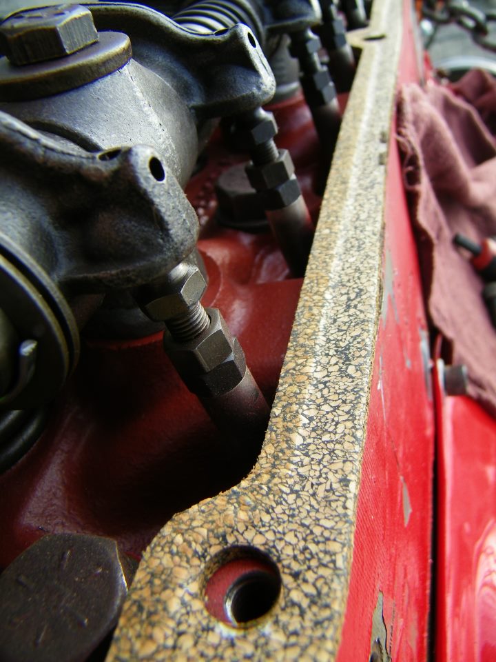

I was told this engine was rebuilt years ago (10-15 years) and never ran because it wouldn't fit into its destined Ranchero. I pulled the valve covers and found hefty adjustable pushrods and very clean valve train. Under the valley pan I found hydraulic lifters and a cam that did not appear to be run yet. I was told when this engine was purchased a 6x2 log manifold was also available separately for an additional price, but the buyer passed.
So I'm hoping this engine has the internals on par with a 6x2 induction setup.
enjoy -
New MEL in the stable

Re: New MEL in the stable
1958 383, 410 and 430 had no provision for mid side mounts like the type you have in your pic. They had a front side mount only.
'59 and '60 blocks had both mount locations and the front side positions were used on the 430 Thunderbirds.

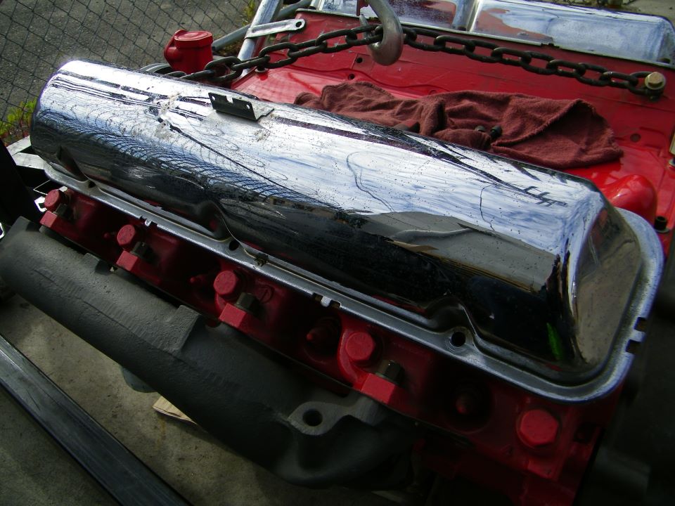

Nice piece, sweet valve covers. Bolt it in an run it!
