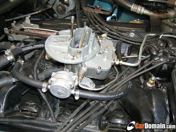

Here are two photos of a 62 installation. Not too clear but may help you. Just ask for any more info-

where does the small port on the water pump go?

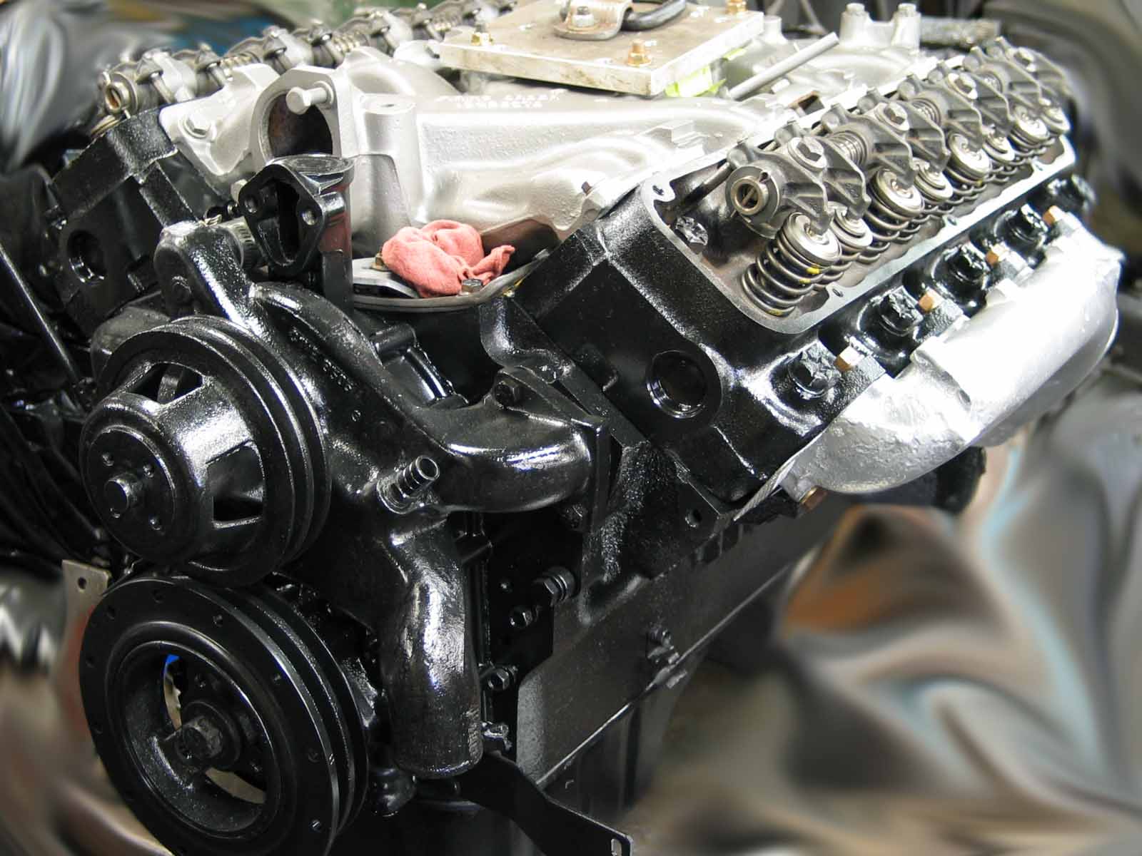

thanks,
-scott noteboom
That will be the return port from the line that runs down the left side of the intake manifold.
Photo is of a 63 LINC, but the ports are the same-
