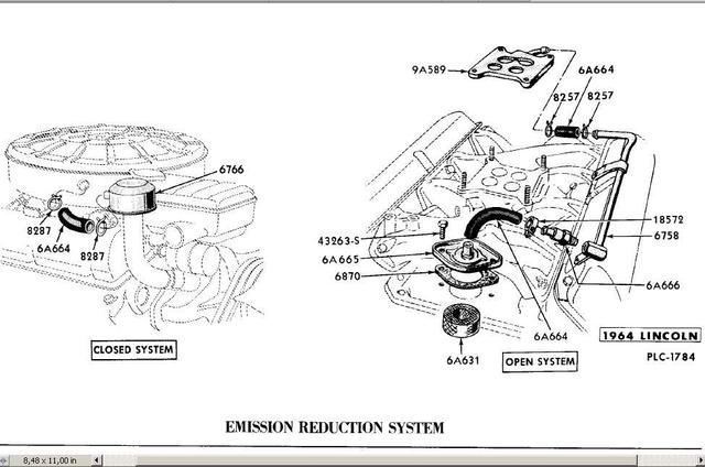

Jeremy, is yours an open or closed crankcase ventilation system?

I have a closed PCV system. I don't think the filler cap is sealing very well at all. Could it be as simple as that?
