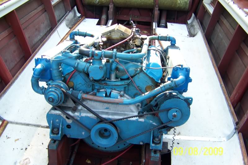

I just picked up a couple more engines... 1960 or 1961... How can I tell by casting numbers?
And... what is the difference between a 65 and a 60 or 61? These are marine conversions by Chris Craft, and the cooling varies slightly, but that is a marine only difference...
I am considering a roller cam etc, so I understand there are differences based on that..?
Here is a photo of a marine 430 ...1965...
Differences between years on the 430

Hi, check out this section. The sticky posts cover a few casting numbers according to various MEL engines.
it would be a lot easier to tell us what you read on your block.
Generally a C denotes the 60ies decade. The second number is the year. So C1 would be year 61 while C6 is 1966.
D would be the 70ies decade and so on.
Note that the block casting numbers did not necessarily change each year becaus design changes haven't been done each year.

Cool... They are 1960 engines. Bought two of them rebuilt complete with less than 100 hours for $500 US
