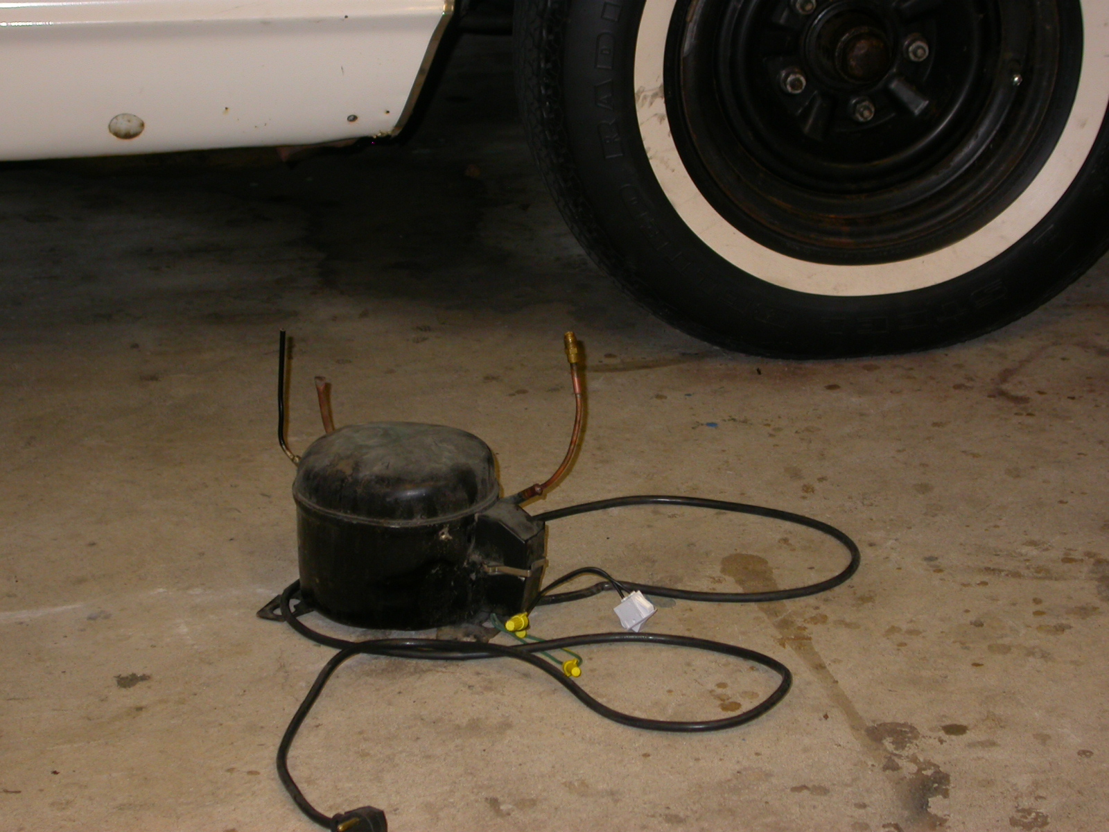

Scope out the neighborhood for an old refrigerator on trash night…Carefully extract the compressor……
like this one….
Fig 4063
Solder a schrader valve fitting, to the suction side, wire up a power lead and an on / off switch as shown.

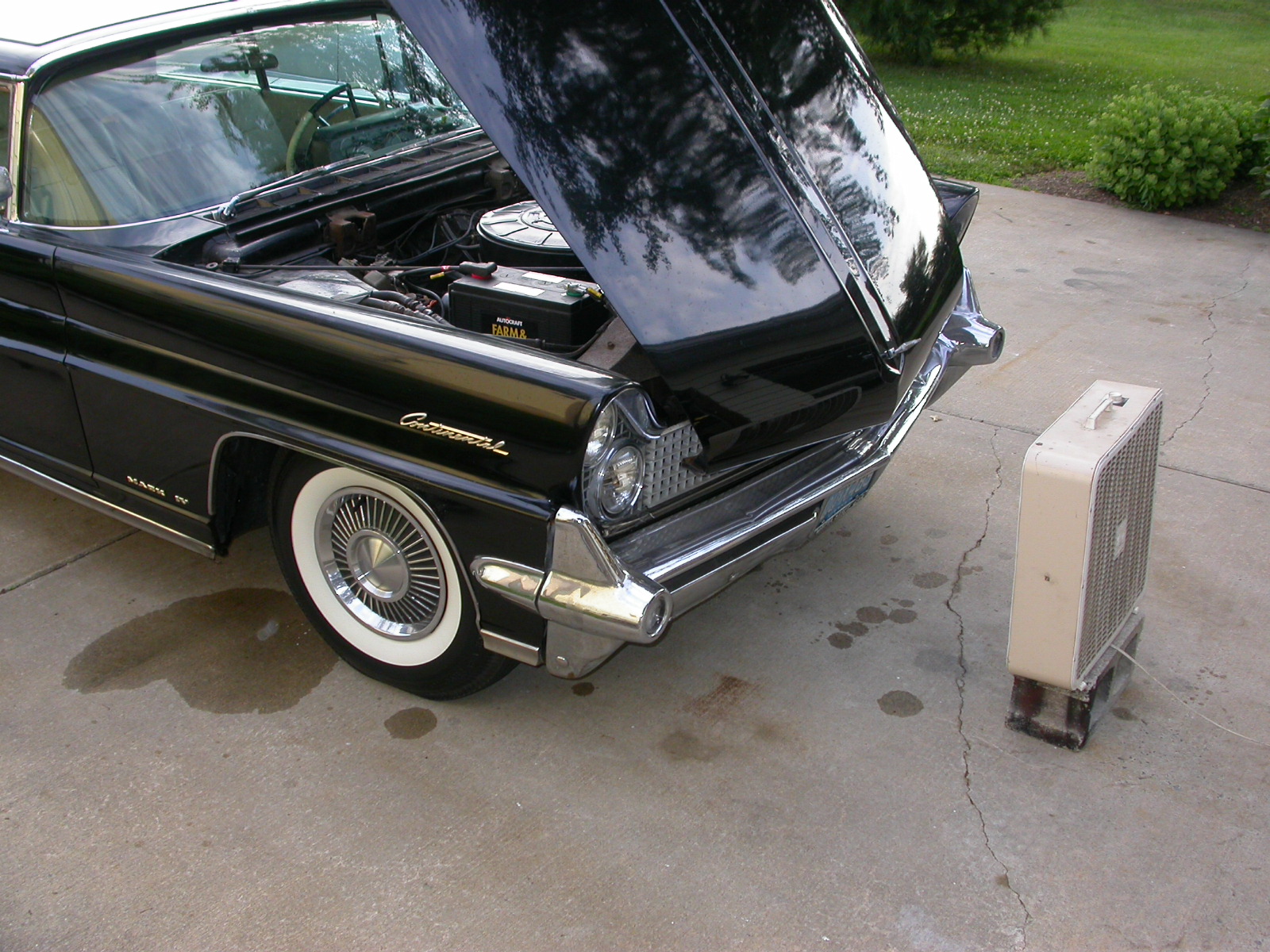

You will need a fan in front of the car to keep the air flowing

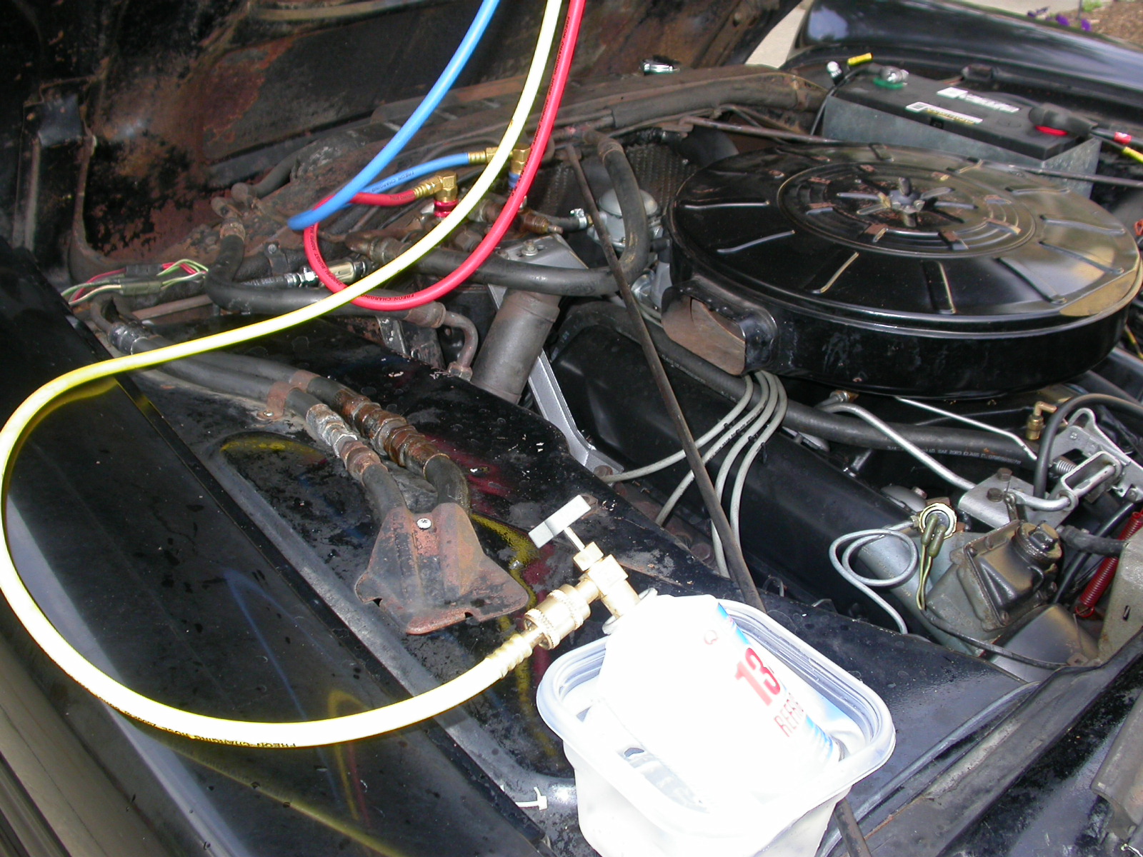

In my case the system needs 4 lbs. of Dichlorodifluoromethane Freon 12 so I converted it to 134A.
If you do, you only need about 85-90 percent of the charge. That’s 64 oz. of 12 vs. 55 oz. Of 134A.
Fig 4059

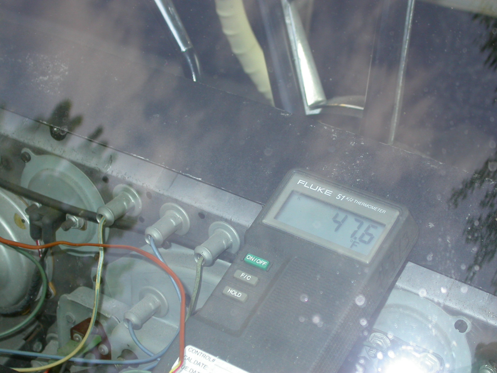

Use your gauges and temperature chart. Observe the Ambient temperature and the temperature of the air coming out of the vents.
Fig 4061
It was 93 degrees outside and I got 47 degrees out of the vents before it was fully charged on a black car.
