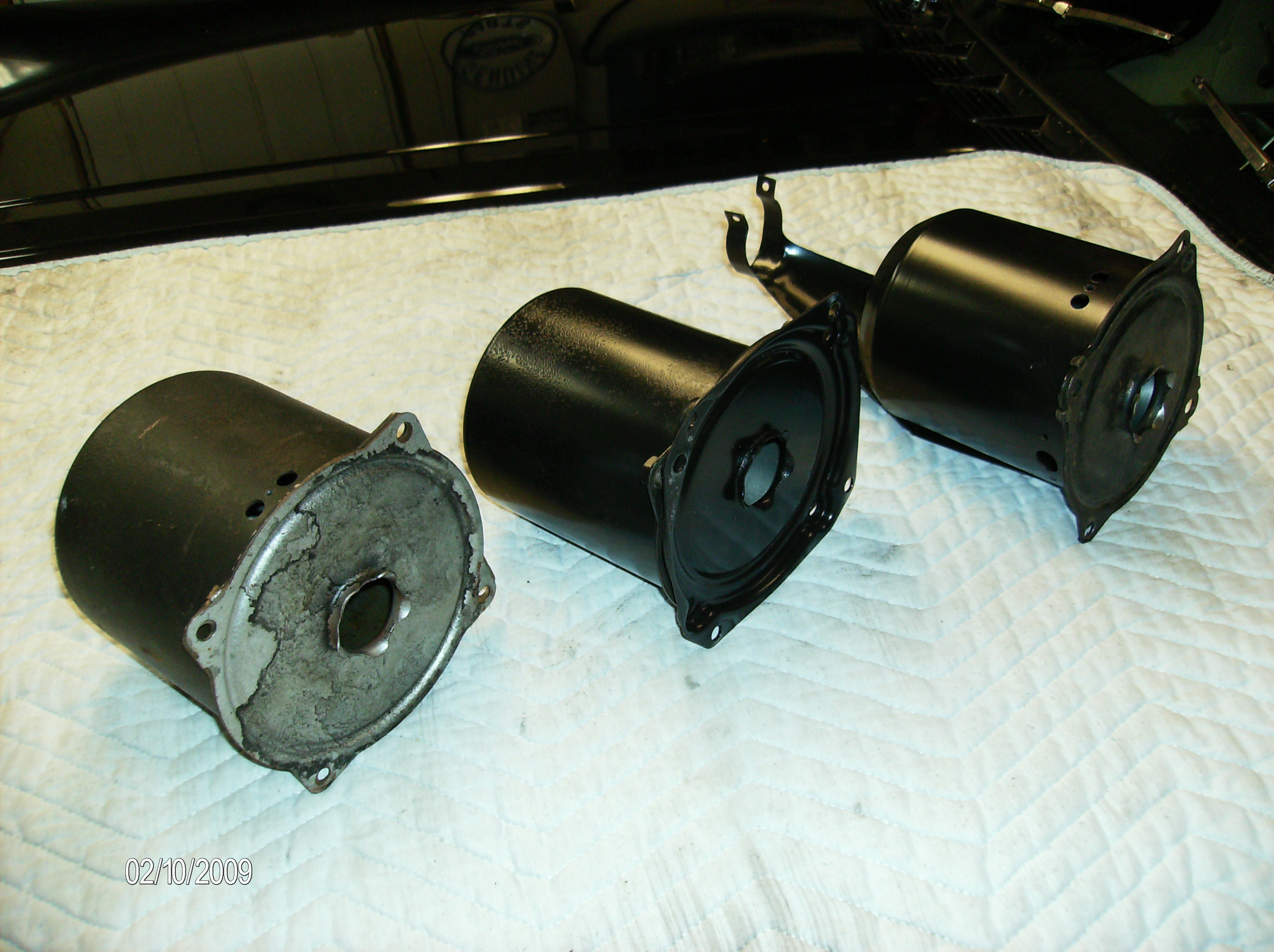

First let me illustrate some differences.
These are various booster types. Different diameters. Generally speaking the larger diameter unit (6")is the Poppet-Valve Type Booster. The smaller Diameter (5 1/4") Pictured in the middle, is the newer design Hydraulic- Reaction Type and the Disc- Reaction Type. This smaller unit replaces or supersedes the Poppet-Valve unit. The units are interchangeable but maybe not correct for the specific model that you have. In fact my two 59 Lincolns one has a 56 Mark II Pop type booster while the other has the correct disc -reaction type they both stop just fine.
Notice the heat shield on the far right unit. This was used on the early Lincolns and Mark II 's due to the placement over the exhaust manifold.

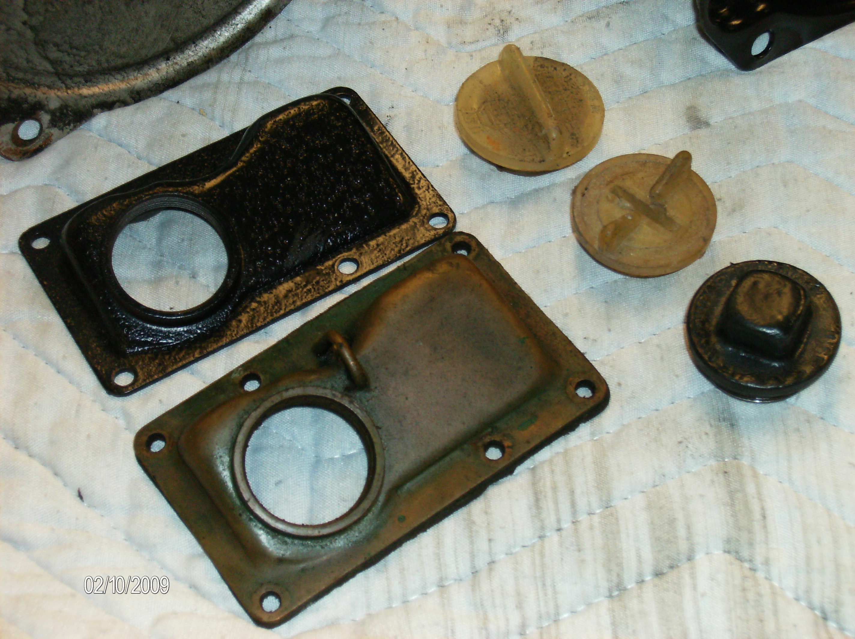

There are several types of tops /covers for the master cylinder....some were vented and some were not. This illustration shows several screw-on lids. Plastic and metal.

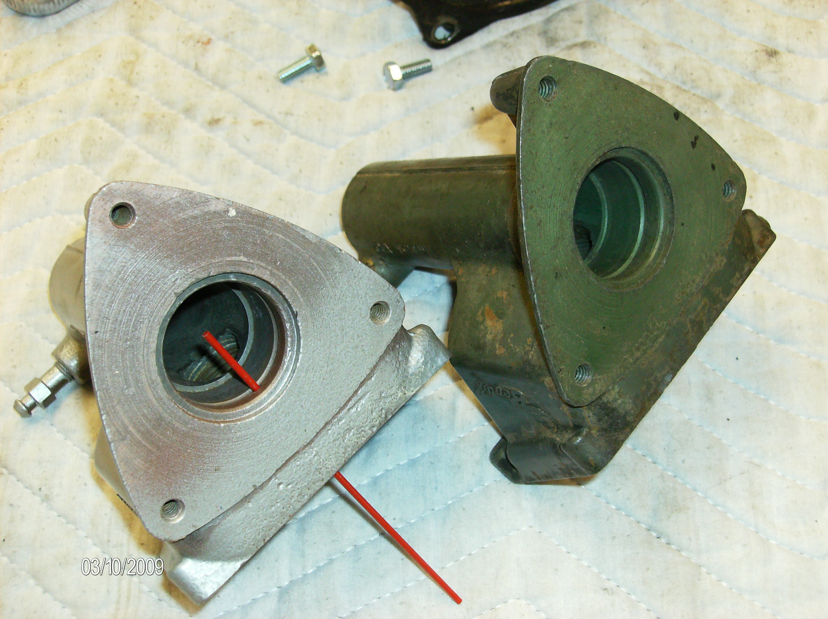

The castings ....some were vented and some were not. The vented unit was used with the Poppet-valve booster that vents to the back of the casting just in front of the dust seal. The purpose of the vent was to allow brake fluid that leaked past the packing seal to find its way back into the reservoir. This prevented the brake fluid from entering the vacuum booster and having it drawn into engine or auxiliary vacuum canister. By then the packing seal was comprised and you still had to break it down for repair.
Both of these castings are in perfect condition and are usable. The green finish is correct for these units. It protects the casting from degrading. I will use both of these casting for my cars even though the vented unit in not a numbers matching part the counter bore is perfect.

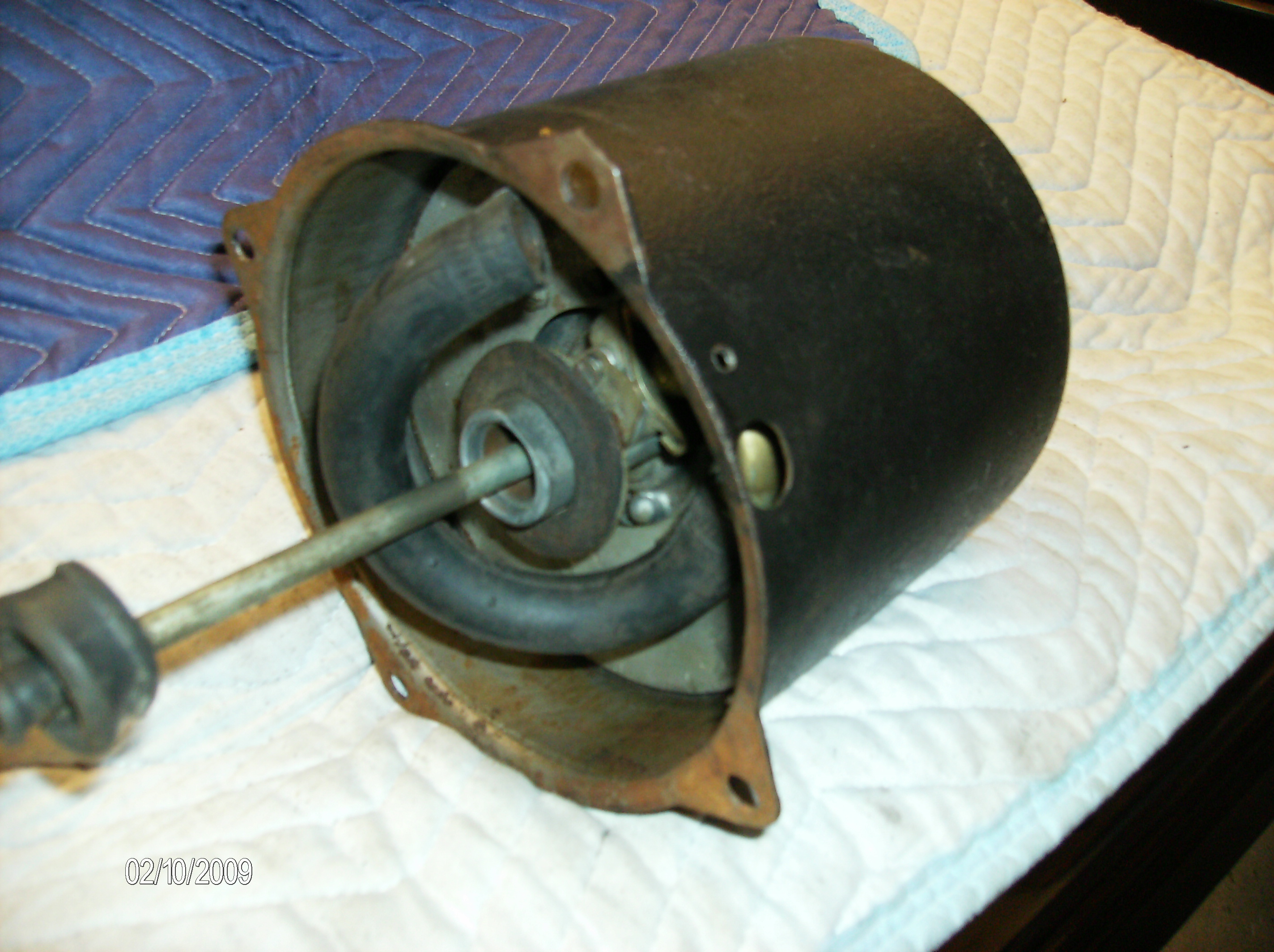

Here is the Poppet-valve booster ...

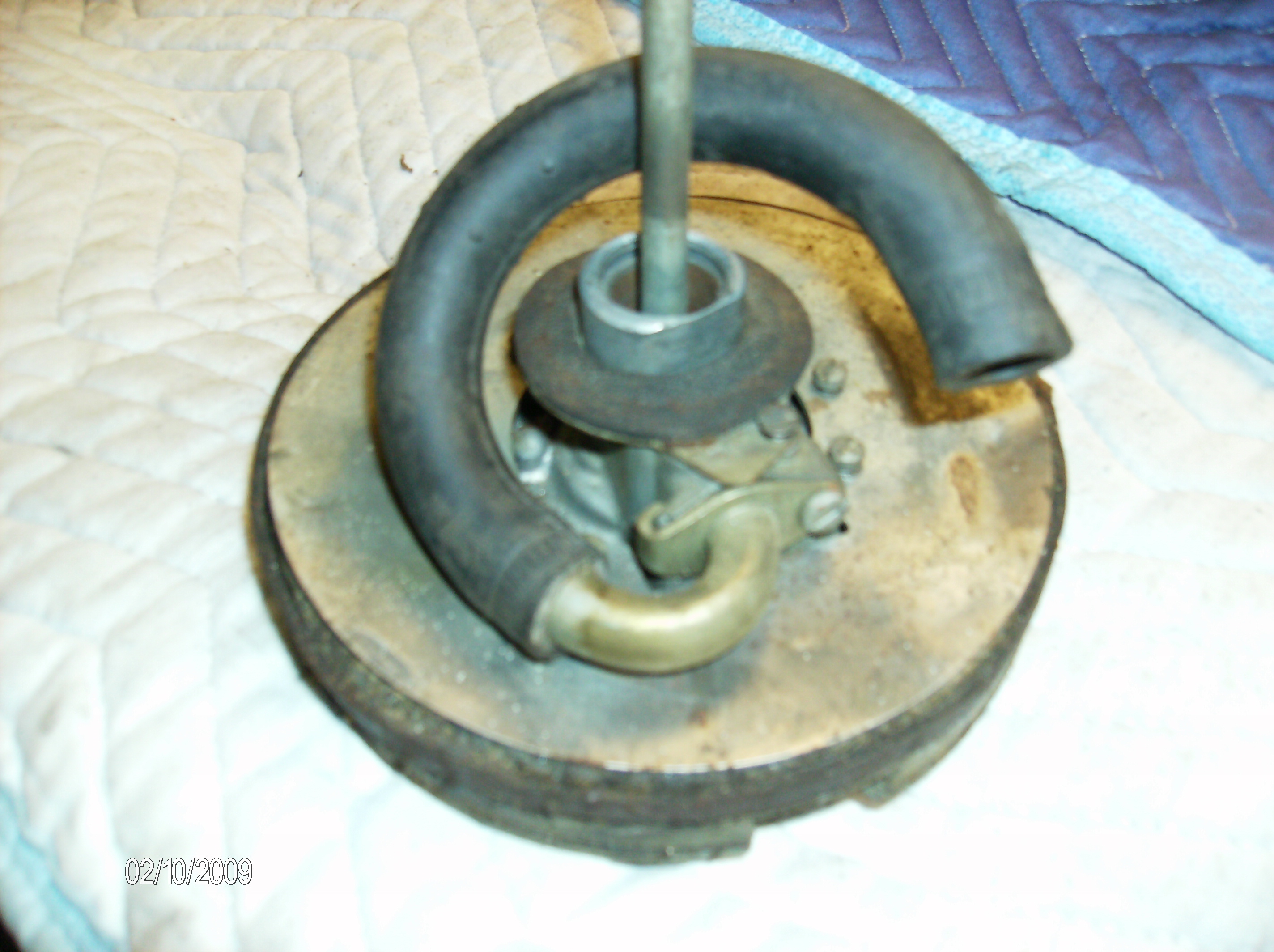

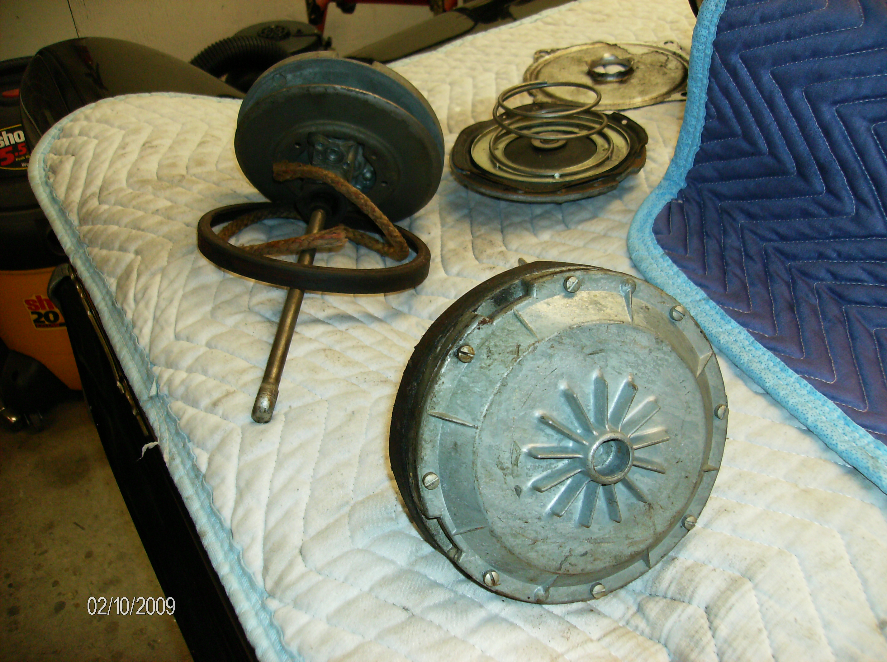

The piston and packing assembly removed from the cylinder
The piston and packing assembly removed from the cylinder in the foreground and Another unit just behind it.

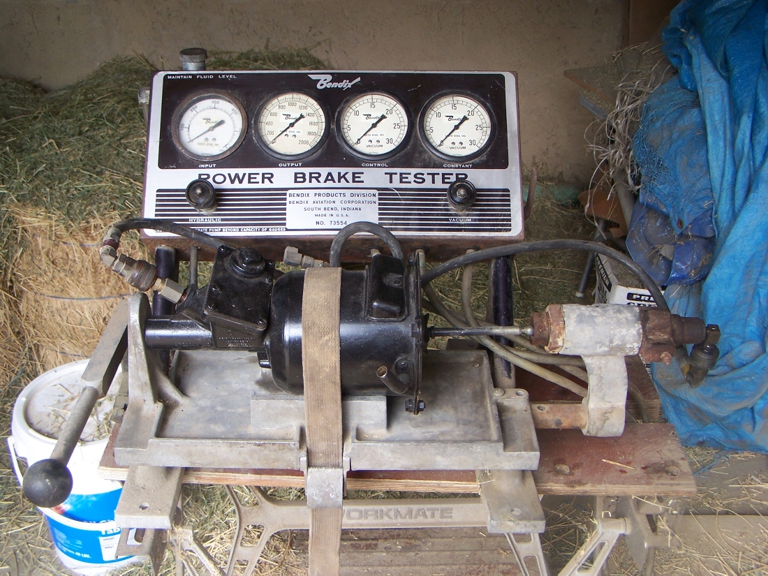

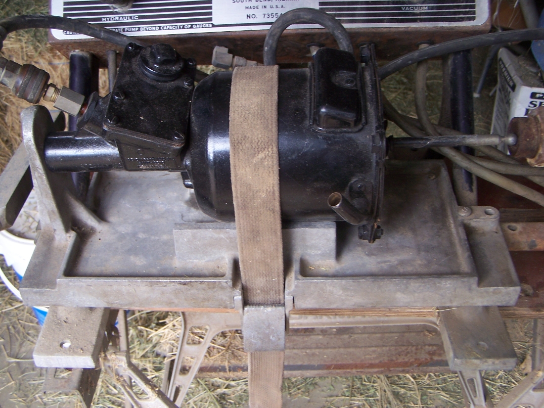

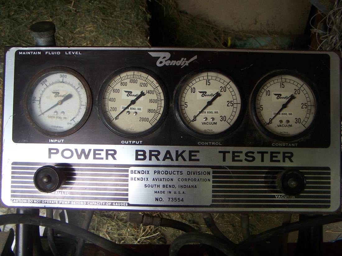

Per your request, 59lincolnrag, here is my Bendix #73554 power brake tester set up with a 1958 Oldsmobile "O-8" Hydraulic Reaction Treadle-Vac under test. I got the Treadle-Vac a few years ago from a collection of rebuilt units that had been purchased from a rebuilt auto parts supplier.
I picked this tester up on eBay a couple of years ago for a whopping $25, and it was listed as a pickup-only item (no shipping considered!). It just happened to be about 15 miles from my home. The input pressure gauge was blown, so I rounded up a replacement from a gauge supply in Orange County, and transferred the "Bendix" and "South Bend, Ind." labels to the new gauge face to keep it looking somewhat authentic.
The whole guts was jammed up with congealed brake fluid, but patience won out and it's now 100% operable. Total investment about $50 and a bit of arm and leg-work.
The Bendix Service and Sales Catalog I picked up 25 years ago at Acres of Books in Long Beach, California, provided the test specifications for this set-up, and all Bendix brake units through model year 1957. With vacuum of 20 in.Hg, this unit will produce between 100 and 190 psi hydraulic pressure with 30 pounds at the input rod, and 700 to 850 psi with 110 pounds at the input rod.
The Mercury/Edsel units will put out between 60 and 140 psi with 30 pounds input, and between 550 and 700 psi with 110 pounds input. The difference is probably accounted for by the differences in the pedal linkage pressure multiplication factor between the Olds and the Merc.

WOW how cool is that!!.........Im excited....OOOOHH Baby!!
