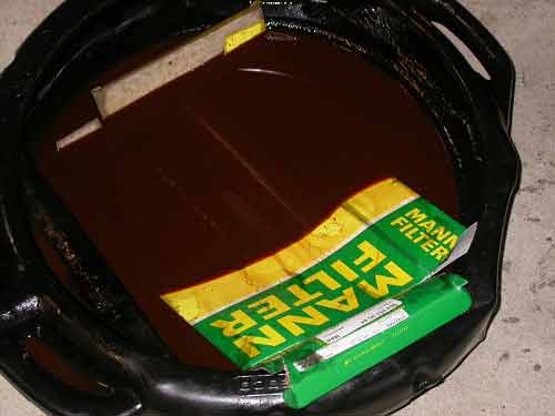

Mmmmmm !!
This is what happens to old fluid ...... Apparently antifreeze got in here through the radiator.

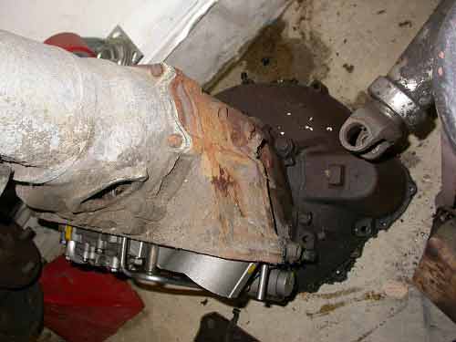

The next step is to drain the torque converter...Remove the inspection cover and rotate the engine so that one of the drain plugs is visible and at the bottom. You can now drain the converter.

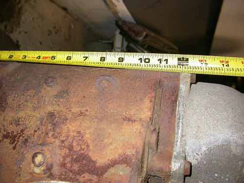

This is a large case unit 10 7/8"

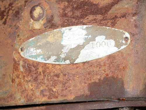

This is the ID tag found on the driver side ....Model PBB

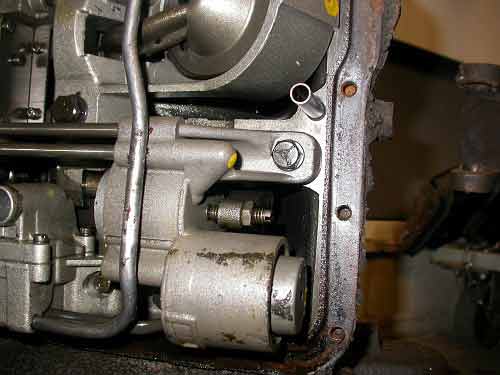

You can make a 1/4 inch spacer to fit between the servo and the adjustment screw shown here. Back off the lock nut back off adjustment screw. Insert the spacer between the piston stem and the adjusting screw. Tighten the screw snug, not tight! Then back off the screw 1 full turn. Then hold the adjusting screw stationary and tighten the lock nut. Remove the gauge block. The front band is now set.
