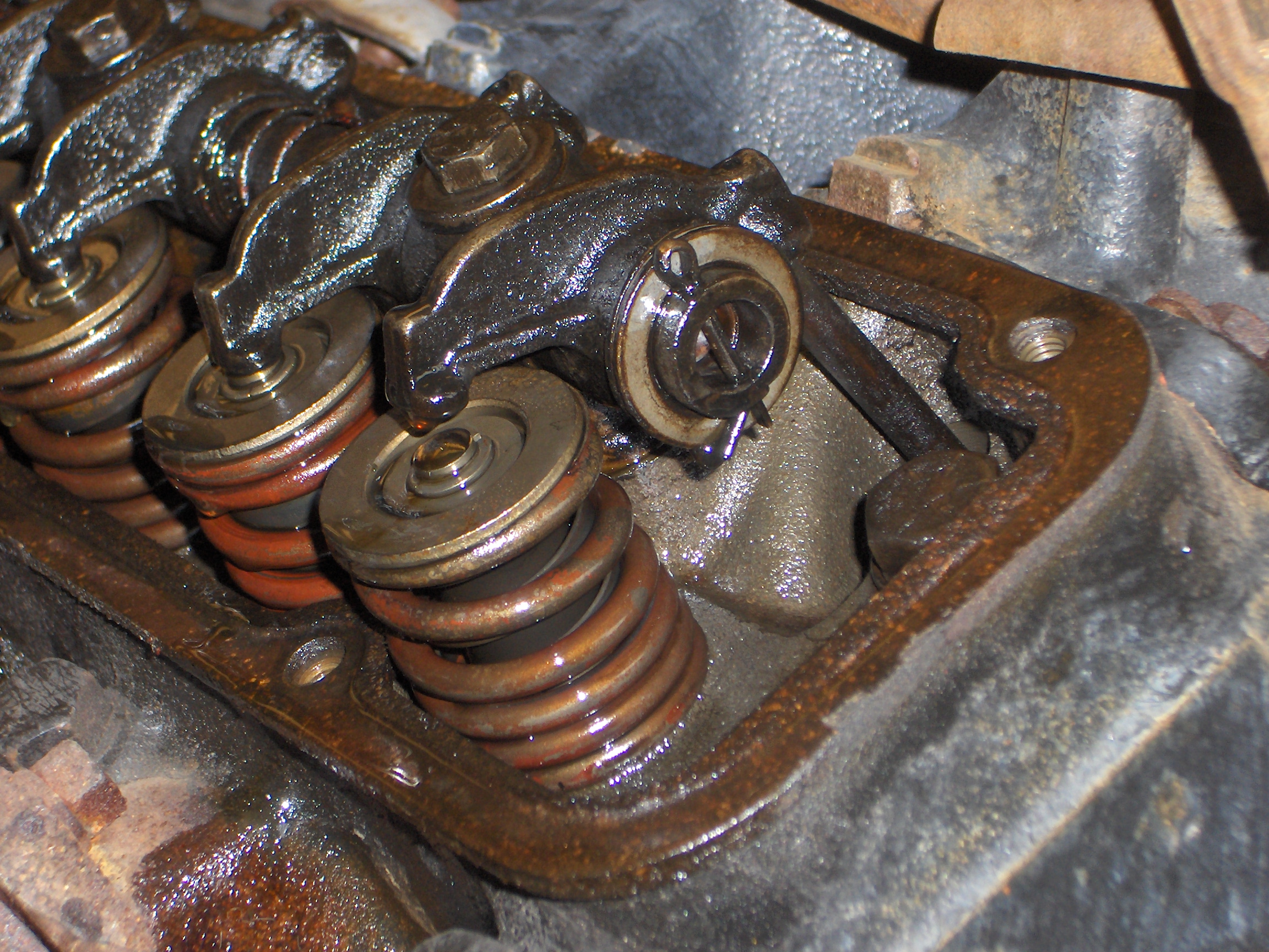

Its a good idea to remove the valve covers at this time and oil up the rockers and valve stems. Pressurizing the system would be my first choice.
Looks like a stuck valve. Squirt a little oil on the stem and lightly tap it with a plastic hammer back and fourth. After a few minutes it popped back in place.
