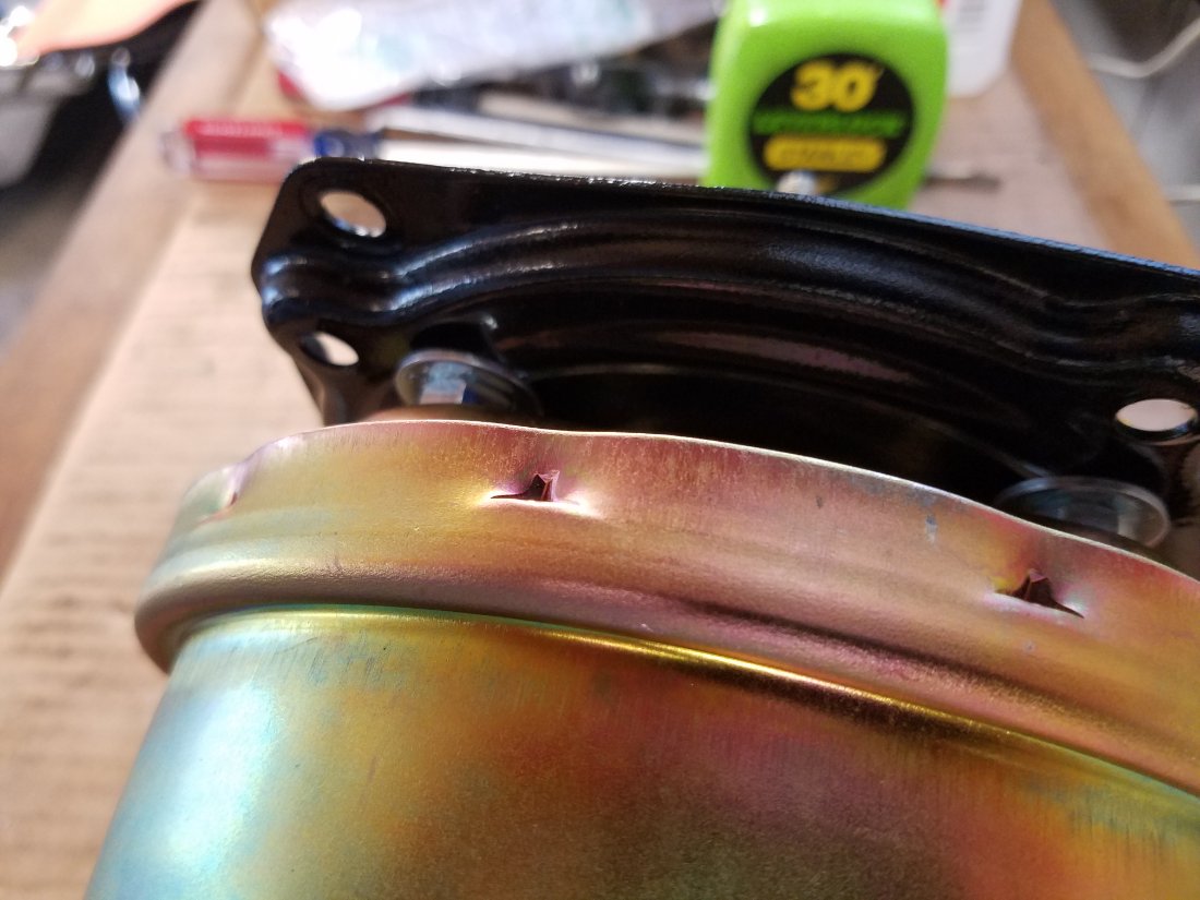

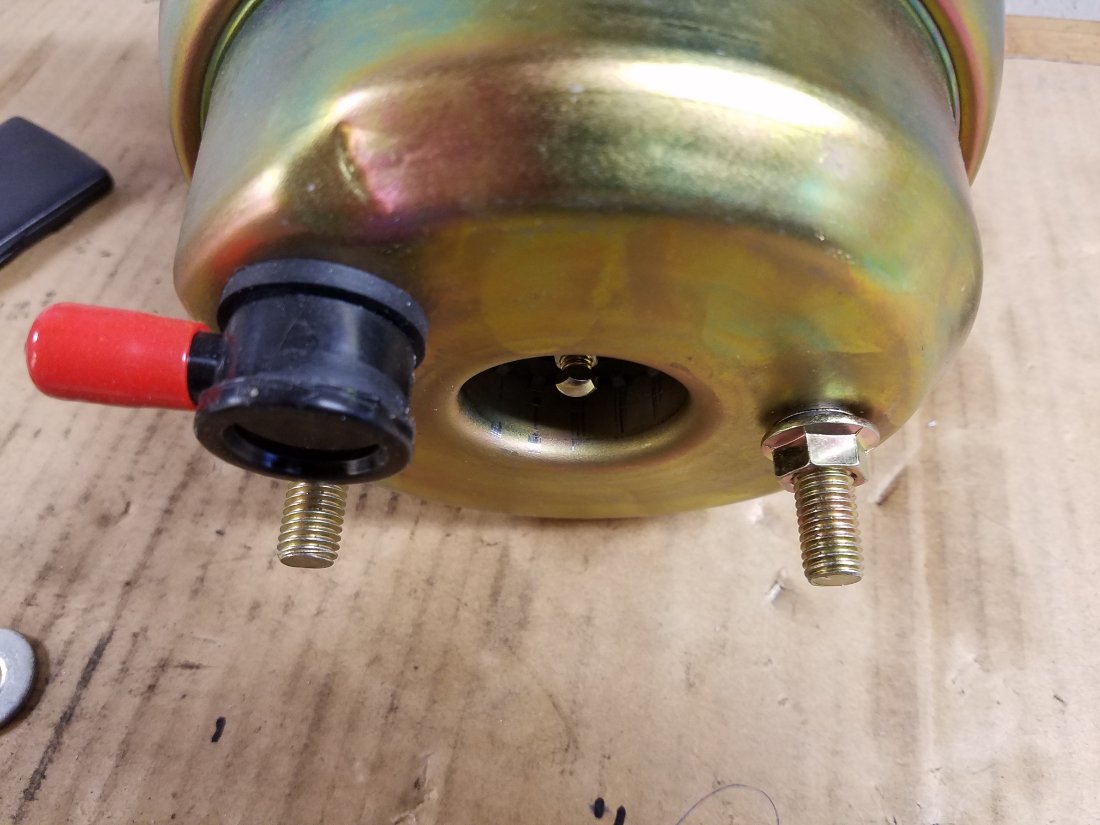

This is a view of the front of the booster. There will be a short rod supplied with the Master that goes here.
Make sure the Master fits in this cavity.

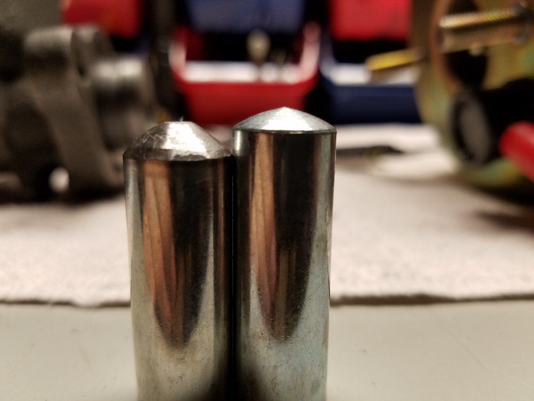

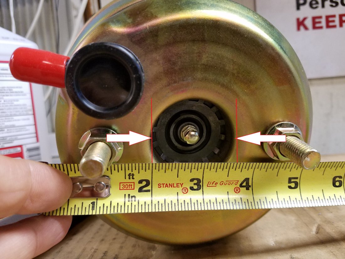

Measure the length of the pin. It needs to be .020" shorter than the actual length measured. This insures pistons are at the rest position. This allows fluid to flow from the fluid reservoir to cylinder for normal operation.
To the left is the re-sized rod. To the right is the original length.
The pin may need to be ground down in order to fit and allow the Master Cylinder to function Properly.
If, when placing the Master on top of the Booster it does not drop in, the short rod will need to be sized.

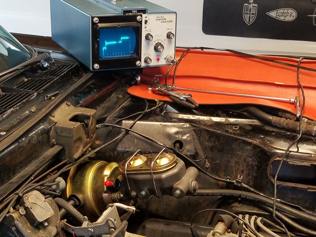

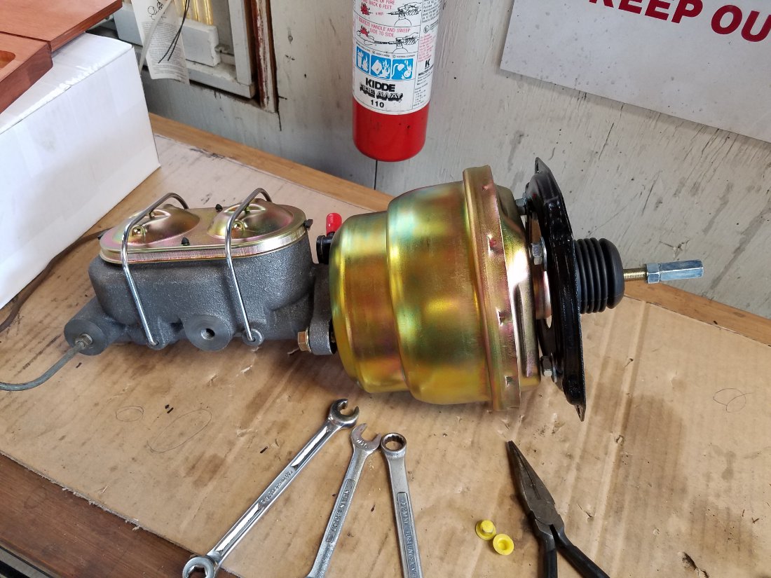

Attach the Master
NOTE> BE SURE TO BENCH BLEED THE MASTER BEFORE INSTALLING IT TO THE BOOSTER!

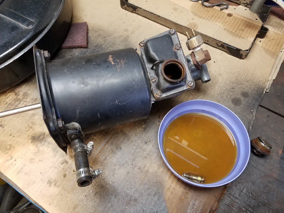

This is why you need to change your brake fluid

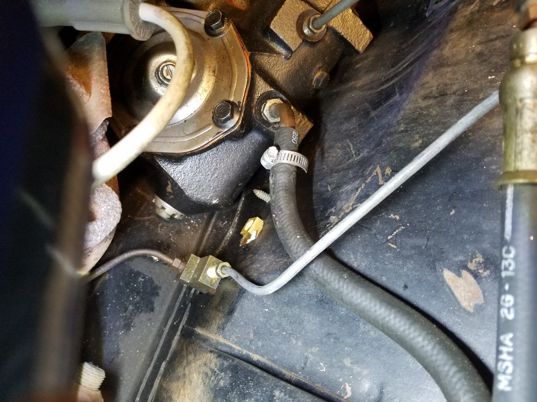

Here is the Junction where one rear and two front brake lines meet.The line running up to the master I will reuse. For the two front brake lines. I will block off the rear brake line port with a plug. I will add an additional junction for the rear brake line and extended it up to the master. The line traveling down is the right front brake. The rear line and the left front line enter the original junction block on the far side of the fire wall not visible in this picture.
The line on the right is the rear brake line . The one on the left is the Left Front. This the the view from inside the fender well.
I will disconnect the rear brake line and plug the port. Using a new junction box I will route the line through the fire wall up to the Master.

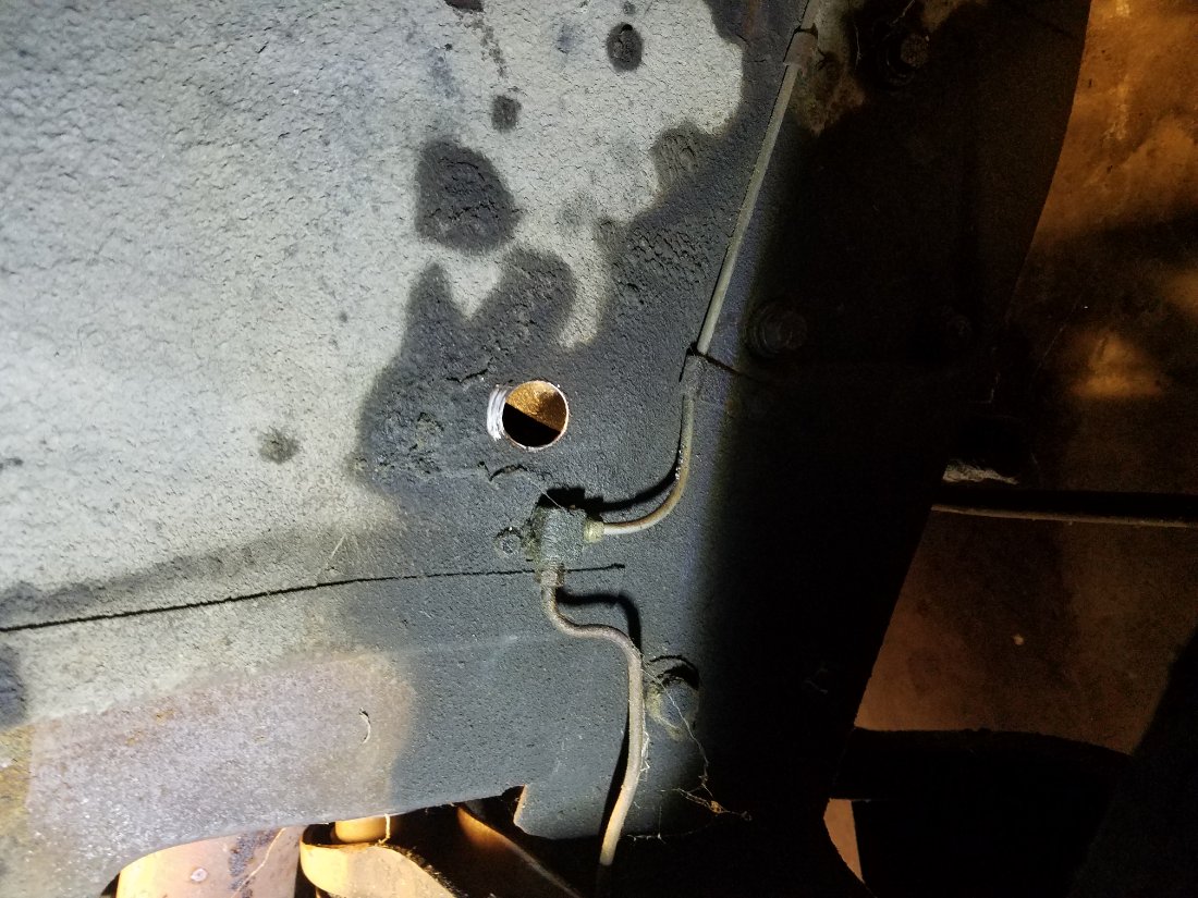

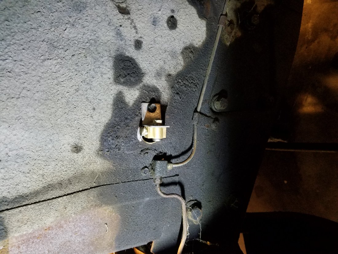

Bore a hole through the firewall.
Attach the junction as shown.

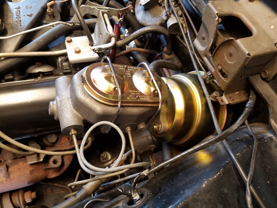

There ya go!
Job Done!
