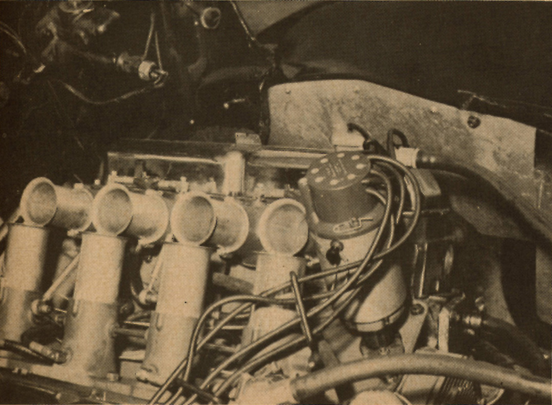

Yep, Dad, it looks like I need to start searching the classifieds here and eBay for parts! Ha ha... welcome to the board, Dad.EdGrist wrote:I noticed the Hilborn injector pics posted by Chris Craft Crazy on the aftermarket induction thread are the same as were used on the Grist Bros MEL (pic above). I imagine a set of those would be a rare find indeed. I'm new to the forum/thread and am enjoying the posts.

Ed, welcome to the ford-mel-engine.com forum. Nice tzo see more MEL people coming together here. Things go a little slow sometimes. That's as much as a small niche community can get to. But the wait for responses and information is definitely worth it.EdGrist wrote:I noticed the Hilborn injector pics posted by Chris Craft Crazy on the aftermarket induction thread are the same as were used on the Grist Bros MEL (pic above). I imagine a set of those would be a rare find indeed. I'm new to the forum/thread and am enjoying the posts.

Not a problem Theo. Thanks for your work administering this site. It already has a lot of good information and has great potential to grow and get better. Keep up the great work.
I honestly do not know that much about the MEL, but would like to learn more. I was 13, back in 1964, when my dad and uncle sold the Willys. But, I remember they used this engine for 3 or 4 years. They were setting records and winning a lot of drag races, including the Winternationals at Pomona in 1961. When they first started using the MEL engine they spun bearings quite often. But, they got together with Ted Cyr and Leland Colb and learned to drill out the oil galleries allowing for more oil to flow to the bearings. They did this and the bearing problems went away. They started out with six two-barrell carbs, but with the help of Joe Reath, were able to put Hilborn injectors on. They were the first in NHRA's A/Gas (unblown) class to officially break the 10-second barrier and they did it with the MEL.

Yepp,the old methods of improvement. I've done this w. several <fe engines in the past. BTW the revolving header of this forum shows a few shots of Ted Cyr in his dragster. You might want to take a look at an overview of those pics here. For Ted just scroll a little further down the page.EdGrist wrote:............ they got together with Ted Cyr and Leland Colb and learned to drill out the oil galleries allowing for more oil to flow to the bearings. ........

Ted Cyr not only helped his bearings with the oil galley mods, he made a main girdle when the blocks started splitting above 800hp
'Course he said they were shifting at 7000rpm on a 50% load of nitro.
On a stock crank.

There might be a couple more pictures floating around out there, but I don't have but maybe a couple more. I don't know of any other pictures of the engine either, other than in the magazine write-up. Maybe my Dad or Uncle has one.bhambulldog wrote:Very cool!I'ld like to see more pictures of the car.

That was key. Dad and Uncle Ralph had a friend that had a blown MEL and wanted to run it in the Willys (he had built it to run in a '55 T-bird, but after that deal fell through he wanted to run it in the Willys). Here is my Uncle Ralph's recount of it, "Towards the end of our racing, a guy named Linde Billings had an engine with a blower. We only made few runs and never really got it tuned properly. The best run was well into the 10s with a speed around 134 mph as I recall. When starting it up for the 4th run it back fired and broke the front-end off the crankshaft. That was our experience with a blower."
Here is a little larger pic of the engine ... the only one I have.
