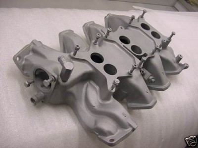

I drove to Detroit and back today... 13.5 hours round trip, and I bought this....
and yep, thats exciting, but look at this...

by reijerlincoln
Nice intake! Does it need custom heads?

by Chris Craft crazy
That is an original Ford motor company super marauder intake.... so just a bolt on.
Now I need carbs...

by Ted
The Mopar six pack carbs are a bolt on. I have the 440 carbs on mine and simply bored the throttle holes in the intake to match the carb bore sizes on the end carbs. The center pivot carb bowls on the Mopar carbs just clear the distributor without having to change over to the side pivot flat faced bowls.
I am going to chicken out, and send the manifold to Joe Bunetic, who I have spoken to a couple of times on the phone. I need mechanical linkage, and marine returns on the tubes..
