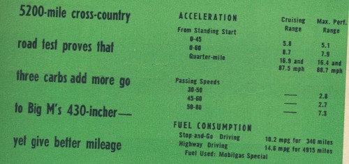

by 58-Pagoda
Here's an item of interest from the Sept 1958 Motor Trend that someone kindly sent me. Don Francisco had one of these setups dealer-installed on a '58 Mercury and then proceeded to test it. He explains how the linkage worked in real-life and how letting off the throttle was like stomping on the brakes.
Throttle linkage follows the trend set by three-carburetor setups on General Motors cars: the throttle pedal controls only the throttle valves in the middle carburetor. All normal driving can be done with this carburetor alone. Throttle valves in the end carburetors are opened by vacuum diaphragms—one for each carburetor—that are actuated by vacuum created by the air flow velocity in the middle carburetor. This divorces the end carburetors completely from the driver’s control, and when they open they open all the way. Vacuum-controlled throttle valves amount to an automatic control of two thirds of the engine’s carburetion—to prevent their throttle valves from being opened at low speeds when the carburetors aren’t needed.
Operation of the throttle linkage during the test followed the plan to the last decimal point but there was one thing about it that I didn’t like. This was the lack of control of the closing speed of the throttle valves in the end carburetors. Under certain conditions the rapid closing of the valves has almost the same effect on the passengers as jumping on the brake pedal. This was most noticeable when passing other vehicles traveling at highway cruising speeds. At normal cruising speeds the throttle valves in the end carburetors are closed but the car accelerates so quickly when the throttle pedal is depressed to pass another car or a truck that its speed quickly reached the point where the end carburetors open. This doesn’t cause any discomfort because all that happens when the throttles open is that the rate of acceleration increases. When the throttle is lifted slightly to allow the car to slow to normal speed again, the valves in the end carburetors snap closed, causing more deceleration than anticipated and throwing the passengers forward in their seats. Actually this quick throttle closing condition is a minor detail in an otherwise highly satisfactory setup. But if I were fortunate enough to own a car with a Super Marauder engine, one of the first things I would do to it would be to install full-mechanical progressive throttle linkage on its carburetors.
During the acceleration tests it was extremely difficult to get the car off the starting line without breaking its rear tires loose. Once spinning, they would stay loose unless pressure was eased off the throttle. This was with the transmission in Maximum Performance Range. In this range the car starts in low gear and then shifts to second and high. In Cruising Range the car would get off without wheel-spin because it started in second gear with only a slight loss of speed at the end of the quarter-mile. Acceleration times for 0-45, 0-60, and the quarter mile suffered less than anticipated when Cruising Range was used.
