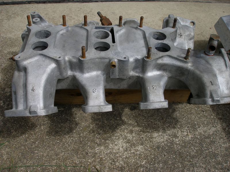

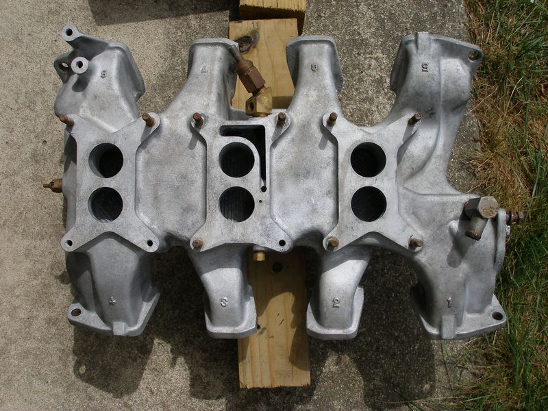

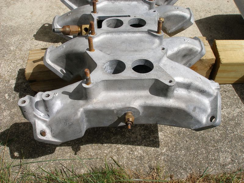

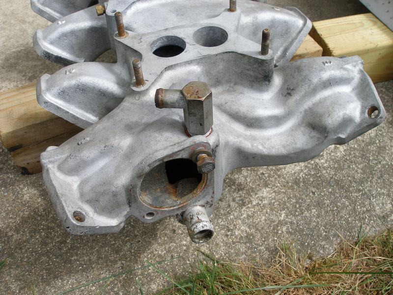

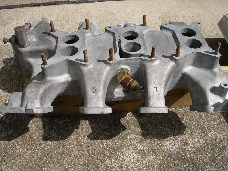

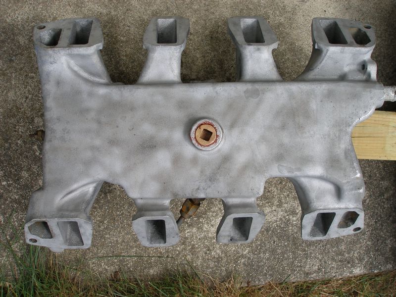

While I was waiting for the intake to arrive, I also found a Super Marauder air cleaner assembly from a local rare parts delear in my area! I thought it was a little strange that it was completely painted. After stripping the paint and soda-blasting, I now know why it was painted - Unfortunately there's some heavily pitted areas. I'll do my best to take care of those areas...
I've got a lot of work to do this winter.
Pics will be posted in a day or two...
Re: tri-power
Did I say a day or two? Should have been a week or two...
The intake looks pretty clean, although I still may media blast it again. There is some pitting on the water inlet for thermostat bypass, and the vacuum port for secondaries was plugged solid. I did manage to get the port cleaned out, but it took some time...
