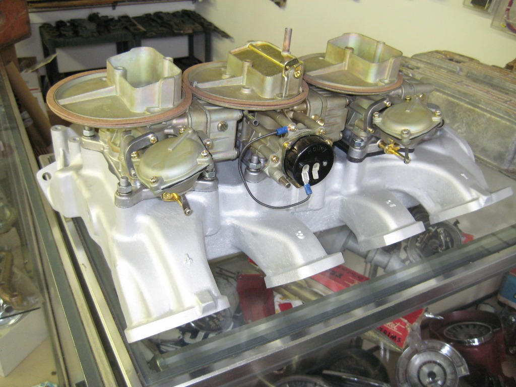

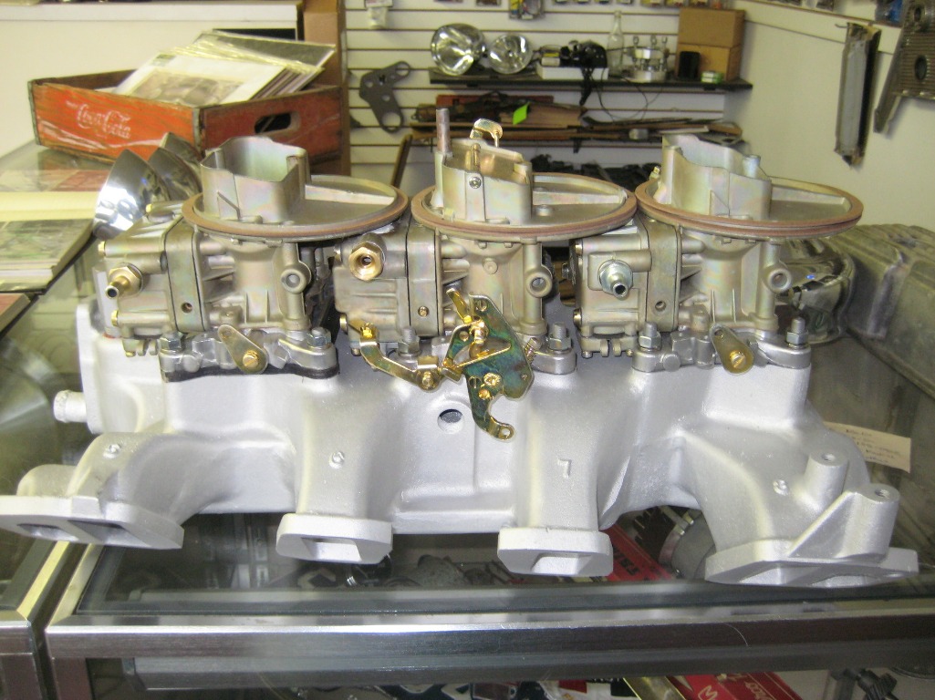

Slowly but surely the rebuild is moving along. There is a linkage problem now, it appears there's some special bracket needed for the center carb for the linkage to function properly.
Looks a lot different from the original photos on page one. I will keep everyone posted. I just hope it's not snowing up here before I get the finished product.

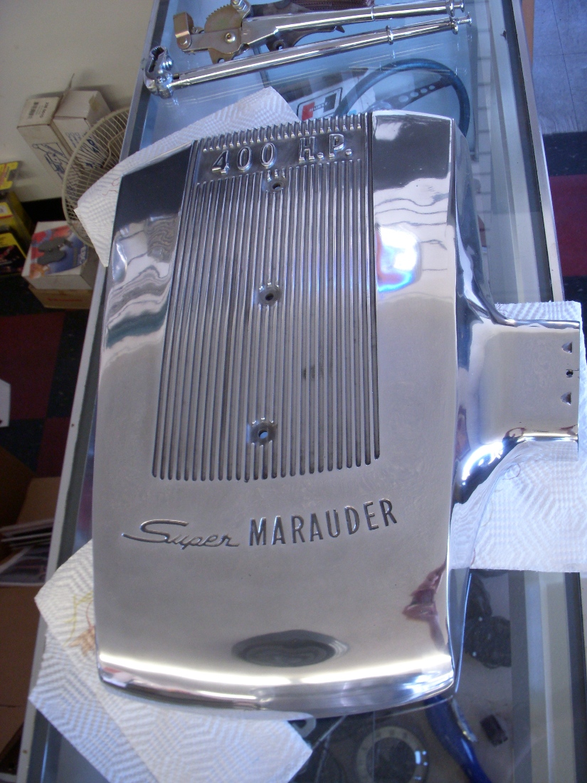

I've got a solution if your interested but you will need a donor hood. I have several for my 66-67 and I may have to do this if I add spacers like I intend to. With my 66/67 the hood will close with a 2" filter (but not with that S.M. cover) but I did not have a spacer mocked up either. I know its very close but I believe 65 and earlier have less hood clearance but I could be wrong.
My proposition is getting a donor hood and making a nice low rise slit across the front of the hood and raising it 1" just like the 1953-54 Packard Caribbean. They have glass hoods but its something that can be done with some cutting on our steel hoods. I will be doing this to avoid the need for an actual hood scoop which a Lincoln would look weird with...but its been done! Good luck and if it done fit..chrome everything out and go hoodless!

Hoodless would be a bad look. I mean bad in a good way. Here's what I got now.
