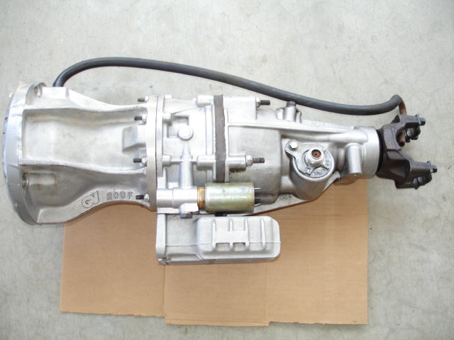

Got more info Pictures!
December 18 2008, 6:25 PM
This OD unit comes with a ford tailshaft and adapters,selanoid,control module so should i grab it if nothing else but to resale? [linked image]

(Login Scode67FB)
Re: Got more info Pictures!
December 18 2008, 7:39 PM
It looks like it's for a Ford C6, MAYBE. But it doesn't look like the Gear Vendors unit that I have.

(Login TorinoBP88)
I think this is the one that Ford used behind the 460 on F250 and F350
December 18 2008, 10:12 PM
trucks. It is not as robust as a GV, it is NOT a GV. and will fail if you shift it under power like can be done with a GV... also the solinoid gets sticky or fails from time to time. But for 150$ Id grab it if you have a use for it. They live under normal 460 (250 HP) duty...

(Login BillBallinger120)
I think it related to the Hone OD and it is an older design
December 23 2008, 10:20 AM
It would still be worth $150

(Login cammerfe)
I have A GV unit....
December 19 2008, 12:57 PM
on my C-6. Note that the castings all have a GV logo cast in. Also there two different ways to attach a GV unit to a C-6. The shortest version requires the complete tear-down of the trans. You must use a special GV short output shaft. In that case, the adapter is only a few inches long. The other way installs the GV unit to the end of the regular extension housing. This makes for a complete trans/GV that's over a foot longer than a regular C-6. And it's considerably less able to handle high torque. The short version can be able to handle over 1200 Ft. lbs.
