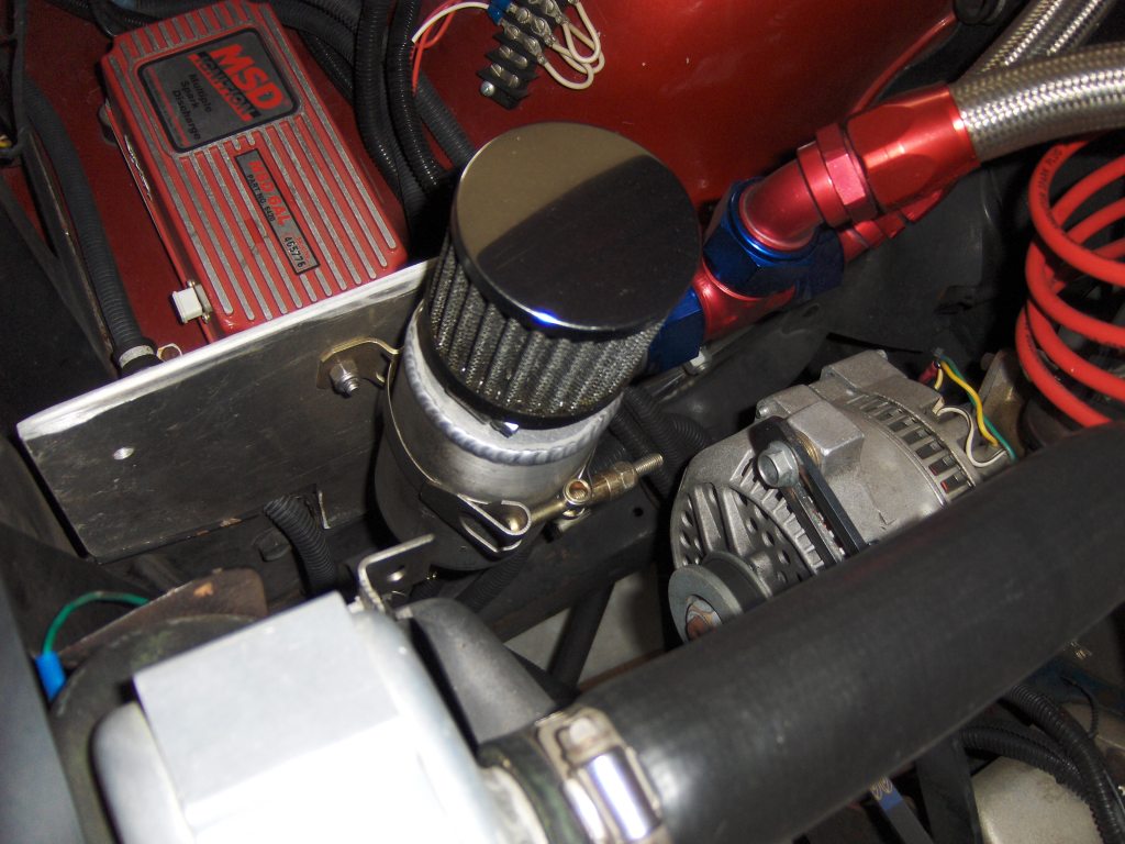

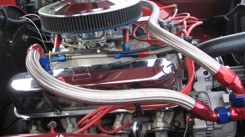

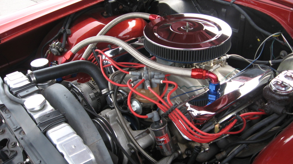

(Login pcode390)
I Share Your Pain
December 18 2008, 3:02 PM
I have two sets of the same covers. I didn't have a problem with oil puking thru the breathers until I installed another set of Ed Heads and changed to the PumpBuilder Stands and ARP Studs. I didn't know about restricting the oil, it was everywhere. I bought another set of Branda VC's with no holes, I also bought Race Type screw in breathers and had 3" risers machined and cut holes in the VC's to match the diameter of the risers. Still had oil everywhere.
You will see my final solution below. It was expensive and looks neat but I need to drain the recovery can every so often.
But I am going to make damn sure the oil is restricted in the new heads for the 445 and am going to retry the screw in breathers with the risers. I can always go back to the plumbing.
Keep a good coat of wax on the VC's and you won't have any rust issues. Good Luck Jason. ww
