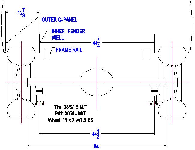

Im looking to see which drag slicks I can fit under my Fairlanes stock wheel wells. A spring relocation change may eventually come but for now I want to get some slicks and wheels. Im looking at 28 inch diameter tires for now. I have made some simple AutoCad drawings of the rear on my Fairlane. I laid out the quarters, inside wheel well lip, frame, spring perches, etc So I have an accurate picture of my available room to fit the maximum width slick without rubbing. I have not accounted for the possibility of rolling the quarter panel wheel lip. This is just background info. My question is about wheels. I dont want to shell out $400 a wheel for some fancy mags just yet. Ill need a 15x8 wheel with a 5 inch back space to fit. A 4-3/4 may be ideal but it would take a more custom wheel. I was thinking of using a steel wheel but I doubt if they are available. Would it be best to get a 15x7 and have it widened to 8 inches? If so what kind of cost is it to usually do two wheels?
The images for those interested are showing my Fairlane with the current street BFGs 255/60/15 and with Mickey Thompson advertised dimensions for 28x11.5x15 ET Drag Radials.

I've used stock Ford 14x7 steel wheels with 28x9x14 MT slicks and they worked great. I've also used steel Dodge 15x7 wheels with 28x9x15 MT slicks and they fit fine as well.
For my 66 Fairlane street car now, I have a set of 15x8 AR TTII wheels made with 4.75" backspacing to fit the 275/60-15 Goodyear Eagle GTs. Car has stock wheel tubs and spring location, as well as Cal tracs. Unless you have disk brakes on the rear, I think 5" BS would be too much, though you could add a small spacer to center it better.

wheelwell. The big concern is the section width, and not so much the tread. The sidewall bulges, and that will usually touch or rub first on most cars. An 8" rim is also too narrow for a 11.5 tire. Should be on a 10" anyway. Tom P will probably know the exact combination that will fit, but you'll have to wait for him to get out of bed.

The problem with Fairlanes is that the wheel well tapers in at the top. The widest slick that will fit without cutting the car or, jacking it way up with air shocks is, a 28 X 9. Before I fully tubbed my 67 I was able to have 28 X 10 slicks fit by mini tubbing the rear wheel wells all the way into the frame rails. With this done the car could sit nice and low and still have plenty of room for the slicks to move around and grow. I probably could have installed wider slicks with that mini tub but a bigger tire at that time wouldn't make it hook harder.
You'll also need a wheel with a 4 1/2 inch back spacing in order to fit right. A stock Ford 15 X 7 inch steel rim from an early 70's Torino with a 9 inch slick will work perfectly.

I had laid this one out and it fits easily. M/T calls out for a 8" wheel as a recommendation. Some say they run a 7" wheel. Is it normal to go against the manufacturers recommendations and still be safe to use? I guess if I went with these I'd need tubes? I've read where some say there are issues by mixing radials and bias tires. I have radials on the front. Or is this only a problem for really fast cars?

If you're looking for dragstrip only use, the 28x9 slick will work great for you. You might even consider a shorter tire to help your gearing. I've run that tire on a seven inch wheel with no issue at all. Used tubes so I didn't have to keep filling them between rounds.
If you want to drive the car to the track with the tires on it, then the radials make more sense. I think you need eight inch wheels for the 275s, but could get by with seven inch wheels with the 255s, plus they are shorter, so your gearing is better and the wheels are readily available.
Regardless of the advertising on the drag street radials, I've never seen them work as well as a traditional wrinkle wall slick.

My 67 Falcon is pretty close to your Fairlane in the back. Leaf spring location and housing width are identical. I can fit a 28 x 10.5 x 15 MT ET Drag on a 15 x 8 x 4.5 BS wheel. It just barely fits and I use a 1/8" thick spacer to keep the tire off the leaf spring - and still get rub marks. I'd use a 10" wheel, but that increases the bulge and the tire would not fit. A 28" tire also has interference problems with the leading edge of the wheel well.
If your drawing is to scale, your illustrated tire bulge intersects the plane of the leaf. I also think the leafs kind of "toe out" towards the back.

It`s been over 30 years since I had the car, but when I raced my 66 Fairlane GTA in the mid 70`s, I used a pair of the MoPar Rally wheels from a 70 Cuda, which were 15x7"`s, with a set of 9x28 1/2-15 Firestone "Drag 500" slicks. I remember having to fold down the tab that was sticking out where the rubber snubbers for the axle housing were mounted, and I also recall rolling up the wheel lip edges, but I can`t recall if that was for actual slick clearance, or to fit my tow hubs and tires under the car. (No fancy ass trailer back then, just a tow bar!)
As for tire size, yes the M/T 9x28-15 is only 17.3" tall, but Hoosier, and likely Goodyear made slicks that are actually 28" tall.

If anything err to the side of too much backspacing as you can always make clearance to the inside easier than outside or use spacers. The 275 tire would be under 11 1/2" section width but i'd still never trust published specs. These people don't own a tape measure and i've had to retub my car to fit a supposedly narrower tire.
There is also a big nasty bump stop perch in the wheelwell that can be cut down then the next obstacle is the leaf spring. On my rusty 66 Comet convertible i've moved the leafs 3" inward into a tunneled out frame and now there's quite a bit of room.
I've got 2 sets of 15x8" stock 60's steel wheels i've made up that are 4 1/2" backspace and 6" backspace. They are done but using centers from stock skinny wheels welded into 8" wide aftermarket wheels and could be made anything in between.
I can tell you that on my car the tire hit the spring and still had no problem with the snubber on the frame. Those are still on the car. On our 70 Mustang, the same tire on the same wheels clears all over the place with about 1" to the springs.
