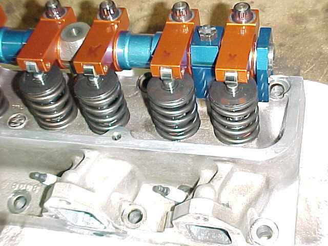

Harland Sharp rockers / Pumpbuilder end stands
December 8 2008, 4:03 AM
I like the Ersons too, but the Good Harland Sharp rockers with Doug's end stands are just as durable and about $100 cheaper. See picture below...
(Login fordsel)
yes
December 8 2008, 4:28 PM
excellent set-up.

I bought the end stands and spacers from Doug
December 8 2008, 7:26 AM
End Stands from Doug = $125
Spacers from Doug = $40
Harland Sharp Rockers from Summit Racing = $400
Total = $565 for my setup. The Erson setup is $800 I think.
I used stock shafts and four stock center stands. If you need shafts Doug gets $140 for a pair of those.
I don't use Doug's rockers because he uses a ball / ball pushrod. That is a waste for me since I have piles of different lengths of ball / cup pushrods. Doug makes a nice rocker, wish he would change to cup style adjusters.
