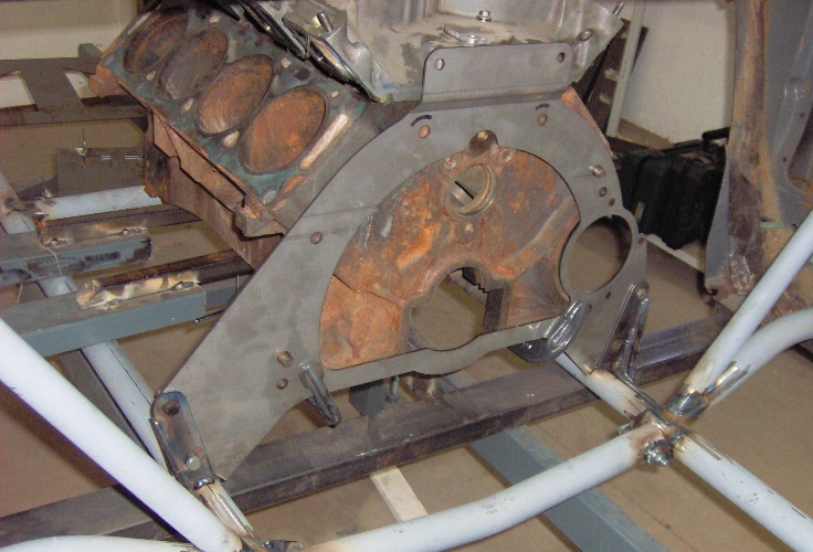

I am somewhat ready to start building an engine for next year, dug out my other 428 block. I knew it was not in the best of shape and it wasn't.
But I had a early 60's 391 block that I had used as a dummy building the T-Bird.
[IMG][linked image][/IMG]
I had chaecked it with drill bits and it was the same as my 428 block so the only question was core shift, if there was any and how much.
