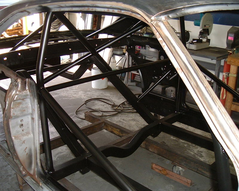

This is a full roll cage in a 1966 Fairlane but the bars go through the package tray from the main hoop.
[IMG][linked image][/IMG]
