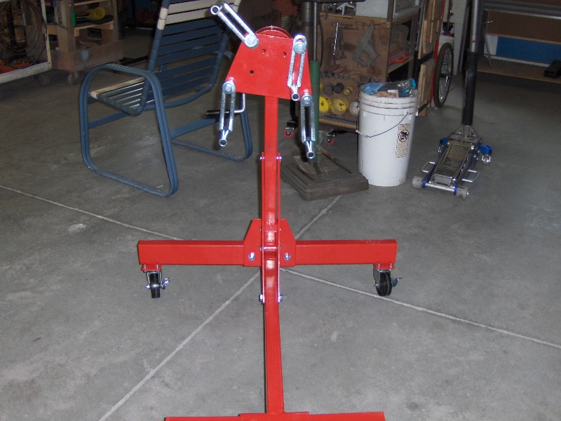

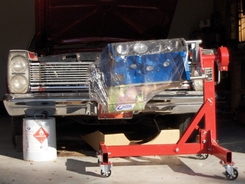

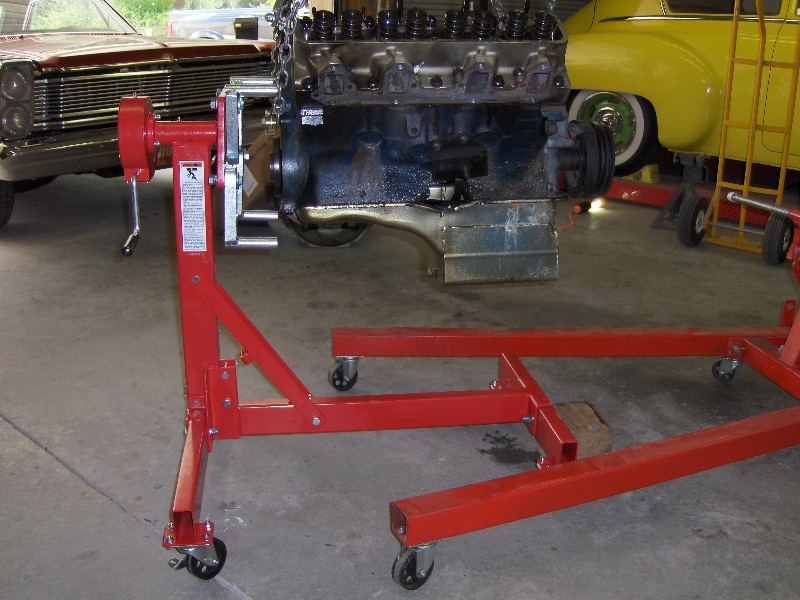

I Have The Sunex Stand
November 26 2008, 8:48 AM
So far I've had a complete FE block with ED heads, no intake and no accessories on it. It sags quite a bit but thats because the upper engine support portion can fold down on the feet. I looked at the other stand rated at 1250 lb, with that one the front legs fold up like a cherry picker.
As far as storage goes the 1250lb model takes up a smaller footprint than the Sunex when folded. But then the Sunex could be stored under a bench.
As far as usage goes the Sunex has a lower weight capacity but the location of the front wheels compliments the legs of your typical folding engine crane. Where as the 1250lb model has the same wheel stance/arrangment a folding engine crane and I see that as a problem when getting an engine off the hook and on the stand.
As far as rotation goes the Sunex can stop anywhere in the 360 deg circle. Although it does not say it the previous ad for the 1250lb modle only locked in 8 positions.
So far my Sunex is working fine and it rotates smoothly and bolted up to the FE bellhousing arrangment with ease. I might do some fabrication to elininate the folding function which will cure the droop
I checked the Northern Tool web site and they do not list the Sunex at this time. I paid $299 and it was free shipping.
I'm trying to add some pics but for some reason its not working. I'm going to post this and try again. ww
