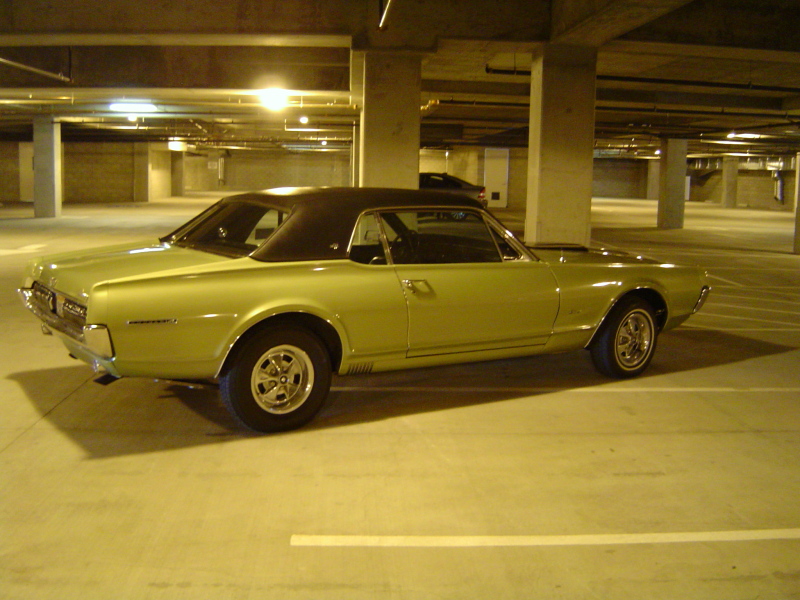

Cougar 390GT S-code, C-6, 3:00 highway flier
What is your desired useage, more specific useage ?
I'll get out the popcorn.
