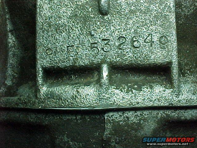

The same VIN should be stamped on the top of the transmission
November 17 2008, 6:43 AM
Just forward of where the tailshaft mates with the trans case. Sounds like you have the 428-4V engine and trans from a full size Mercury passenger car.
Like this:
