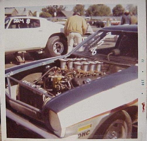

Here is my Pinto I built in '71 [linked image]
kelly
(Login lowriser)
thats the bitchinest picture Ive ever seen
November 7 2008, 7:50 PM
wow. Thanks!
gary o
(Login 70ranchero)
Re: thats the bitchinest picture Ive ever seen
November 7 2008, 10:10 PM
