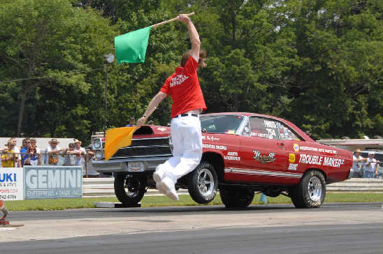

Anonymous
(Login FEforlife)
This one??
November 1 2008, 2:32 PM
