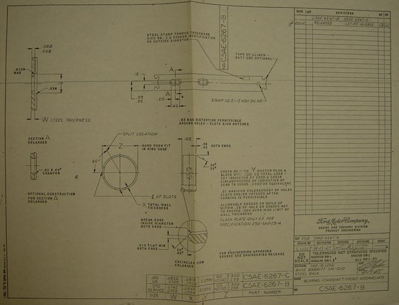

For the center oilers, I think the #1 cam bearing indicates the designed position for all the bearings (it can only be installed one way)
Here is the image showing the split in relation to the oil holes (side-oiler)
