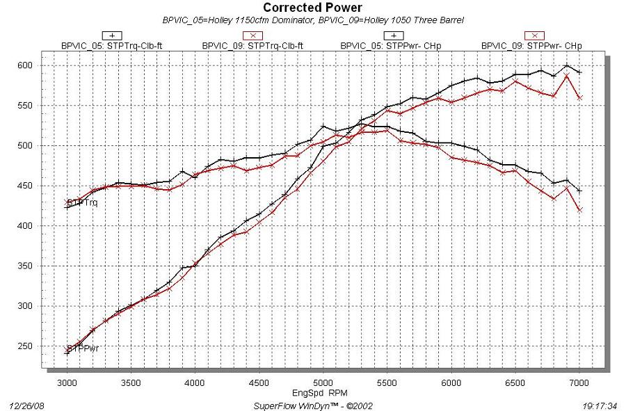

This morning I read some of the comments from my previous post stating that the mismatch between my adapter and the Dominator pattern on the Victor was the reason for the poor performance of the 4150 carb. I'm not buying one bit of that explanation, because I already tested for that on my 500HP stroker 390 engine. I do in fact have four Victors at my place, two with Dominator flanges and two with 4150 flanges. Testing on the other engine yielded no difference between the two port matched Victors, one Dominator flange and one 4150 flange, using the same 850 cfm Holley carb. Also, using the logic that the flange mismatch was the problem, the Holley 3 barrel carb would not show an improvement over the 1000 cfm 4150 carb. The actual results, however, showed that the 3 barrel carb was nearly as good as the Dominator:
The three barrel I borrowed was a pretty used up carb, and I thought it could be improved with some work to come even closer to the performance of the Dominator, but in the end I succumbed to the logic that three barrels just aren't available these days, so despite the performance of the three barrel I decided to proceed next with the Dominator on the 4150 adapter.

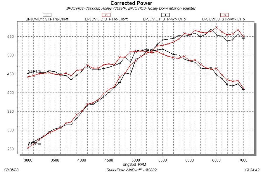

Next we swapped the Performer RPM intake back onto the engine, and installed the Dominator adapter and the Dominator carb. Unfortunately, this combination didn't work out so well. At the top end of the pull, this combination resulted in rough, uneven running of the engine. Where I expected to see this combination pulling away, it basically fell flat, barely outperforming the 1000 cfm 4150HP:
We ran this test three times with the same results in all cases. All the tune parameters, such as A/F, looked pretty good with this combination, but it just went really weird at the top end. Basically, it appeared to us that there was some kind of issue caused by the large adapter spacer, like an intake tract pulsing or resonance, that killed the top end power of this combination.

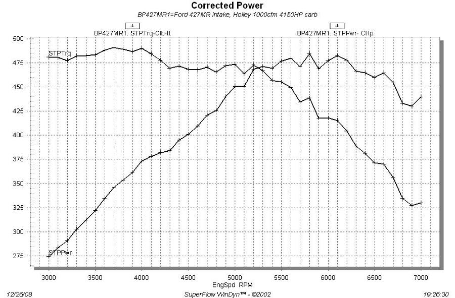

My friend Kevin had brought over his 427 MR dual plane intake, so we bolted that one on next, along with the 1000 cfm Holley. This manifold had looked pretty good on both the 425HP 428CJ, and my 500 HP 390 stroker, being down only 15 HP or so from the Performer RPM. On this engine, though, it was another story altogether. Much to my surprise, this manifold was down a LOT from the other intakes, peaking at only 480 HP! It also showed very poor upper RPM range stability, surging and pulsing, as can be seen in the dyno plot:
Again this evening, after the testing was completed, some second thoughts about this test have crept into my mind. I remembered that although this particular intake is a 427MR intake, it has been port matched to low riser ports. I'm using Mr. Gasket 202A intake gaskets on this engine, which match the heads. I'm wondering if the port openings of this intake are extending down below the bottom of the gasket? This would expose the bottom of the ports to the valley area of the engine, creating a big vacuum leak. We noticed during the warm-up with this engine that vacuum was lower than it had been with the other intakes. I have a call in to my friend Kevin to have him measure the port openings, so we can determine if this is indeed the case. So, at this time the results for this manifold should be considered preliminary only.

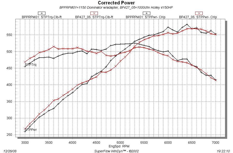

I had high hopes that we would see the same kind of improvement with this setup as I saw with the Dominator on my Victor intake. In fact, based on the previous test there was no reason why we wouldn't see 610 HP with Joe's intake. Unfortunately, it didn't work out that way; here is a dyno plot of Joe's intake with both the 1000 cfm carb and the Dominator carb:
The Dominator did not offer any substantial improvement. The only reasonable conclusion, I think, is that the manifold does not like the goofy adapter.
