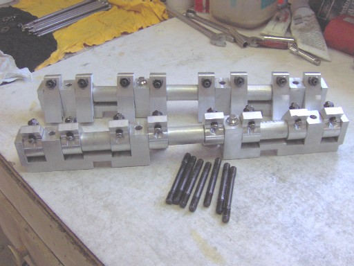

I am an unabashed copier of good ideas I see
My rocker arms are copies of Dove's, rocker stands are the Erson design fitted to the Dove rockers.
But even using mild roller cam springs everything still flexes and galls. I am workjing on my own design for shaft rockers along the T&D or Jesel design. One shaft for each cyl, stands will use the head studs like T&D does. 4 3/8 studs is not "A better idea". LOL
[IMG][linked image][/IMG]
