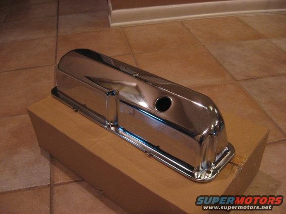

My second choice for VC were chrome pentroofs--I had wanted to stay away from chrome and flash for this car, but, whatever--I want to DRIVE this thing eventually. I ordered a set of Tony Branda's pent roofs with oil holes for $150 and they just came in.
[img][linked image][/img]

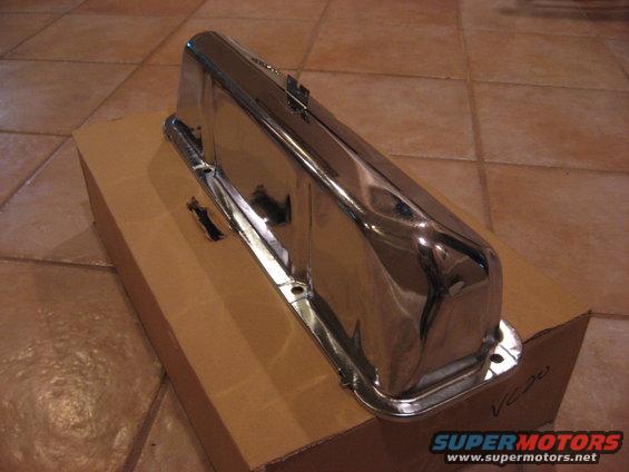

Stamping quality is OK, chrome is alright, but looks like Taiwan chrome and they will probably rust in a year or two. At this point I am disappointed with the quality, but I want to drive this thing. Here is the one that really gets me...
NO OIL BAFFLE! I could have just bought the $39.99 ebay specials and had the same lack of quality and lack of function for much less money. I should have figured--the universe/god doesn't want me to drive this car. I know from experience that I will be sucking oil in the PCV and leaking out of the breather unless I have baffles in there, so here is my actual question:
Has anyone fabbed up baffles or pulled them out of factory covers and installed them before? I am thinking the only way to attach them without damaging the exterior of the cover will be to use JB weld or something--but I don't even want to think about the mess it would make if that epoxy broke loose and the baffle started getting beat to death by the rockers...Any ideas for a frustrated FE'er?
