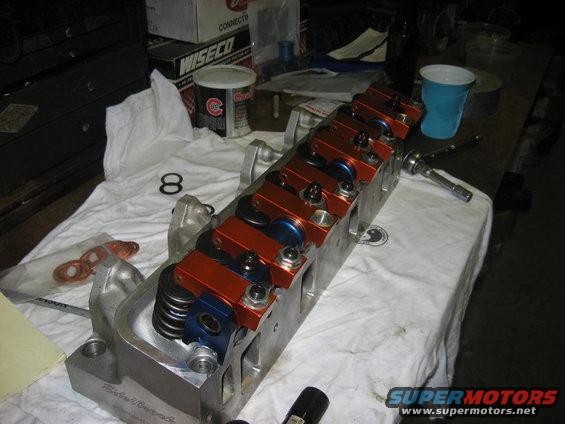

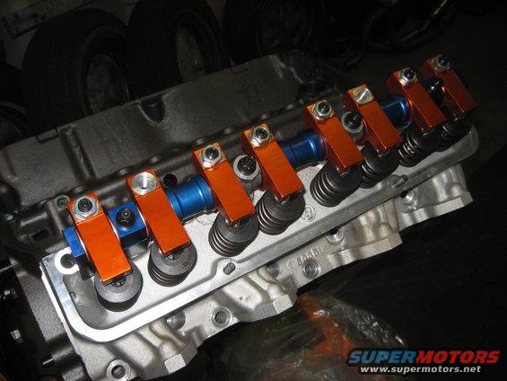

I used stock shafts and stands with Harland Sharp rockers and Precision Oil Pumps end stands and spacers. You could go without the solid spacers, but if you're going to rev the engine much with stock shafts you NEED end stands. I used off-the-shelf Comp ball/cup pushrods. It's also a neat setup if you are a Gator fan...
