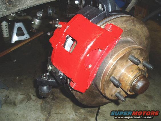

I used spindles off a '77 Monarch (Mercury Granada). I'm not sure if 6 or 8 cylinder cars differ? I have a '89 Ranger Master Cylinder for a truck with manual front disc brakes. I don't use power brakes so no booster is involved. I used the Granada prop valve as well. My calipers and rotors I bought new.
