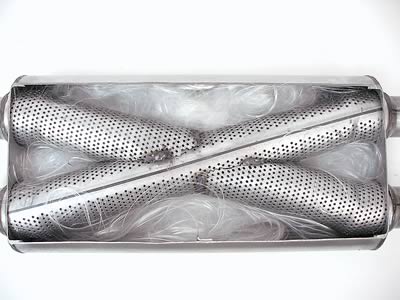

For an X to work, you can't just run one pipe through another. If you do, you simply force ALL the exhaust to go through the area of ONE pipe. When a proper X pipe is made, the area of the merge is GREATER than the area of one pipe, so it's not a huge obstruction. Using a muffler such as the mentioned (pictured below) would result in MASSIVE horsepower losses.
They simply ran one pipe through the other, creating a MAJOR obstuction.
