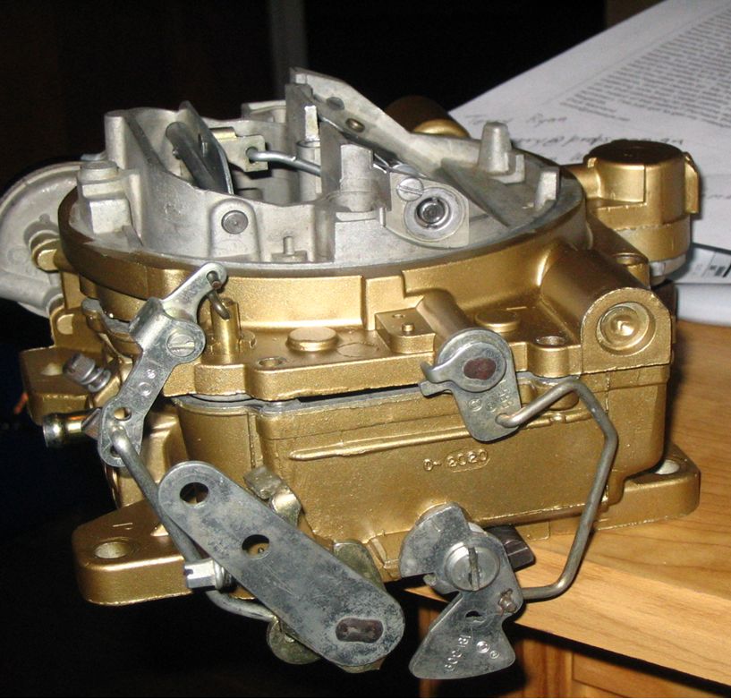

Paul if you do it right it can look like this it takes a little work but mine came out ok.
Paul
(no login)
Mark, you're making me look bad
April 19 2008, 4:58 PM
Somehow it looks like you have been into the Eastwood restoration catalog, with their carb cleaners and coatings. Nice work !
Regards, Paul

Carb
April 20 2008, 8:01 PM
Paul no actaully I have never heard of Eastwood but thanks for the tip. I was in an advance auto parts store and saw this
http://www.partsamerica.com/ProductDetail.aspx?MfrCode=DPL&MfrPartNumber=DE1604&CategoryCode=3268
so I bought a can and used it.
Mark

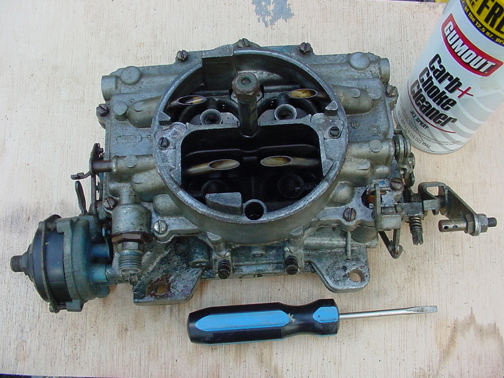

My ongoing Carter AFB carb adventure ( Photos )
April 20 2008, 8:35 PM
Well I decided to depart from my plan, not sure it was an entirely good idea, but time will tell. Rather than rebuilding the starboard carb that has been running on the boat, I took one off one of my spare 427 motors and rebuilt it instead. I dare say, the one that has been running on the boat would hopefully have been cleaner inside, but with all new jets and gaskets, etc., it should now work well. I didn't see anything that looked like it was out of spec, worn, or broken.
Here are a couple photos before I took it apart.
Things looked sooty, but rebuildable.
More photos next post.............................
This message has been edited by FEfinaticP on Oct 17, 2008 4:25 PM

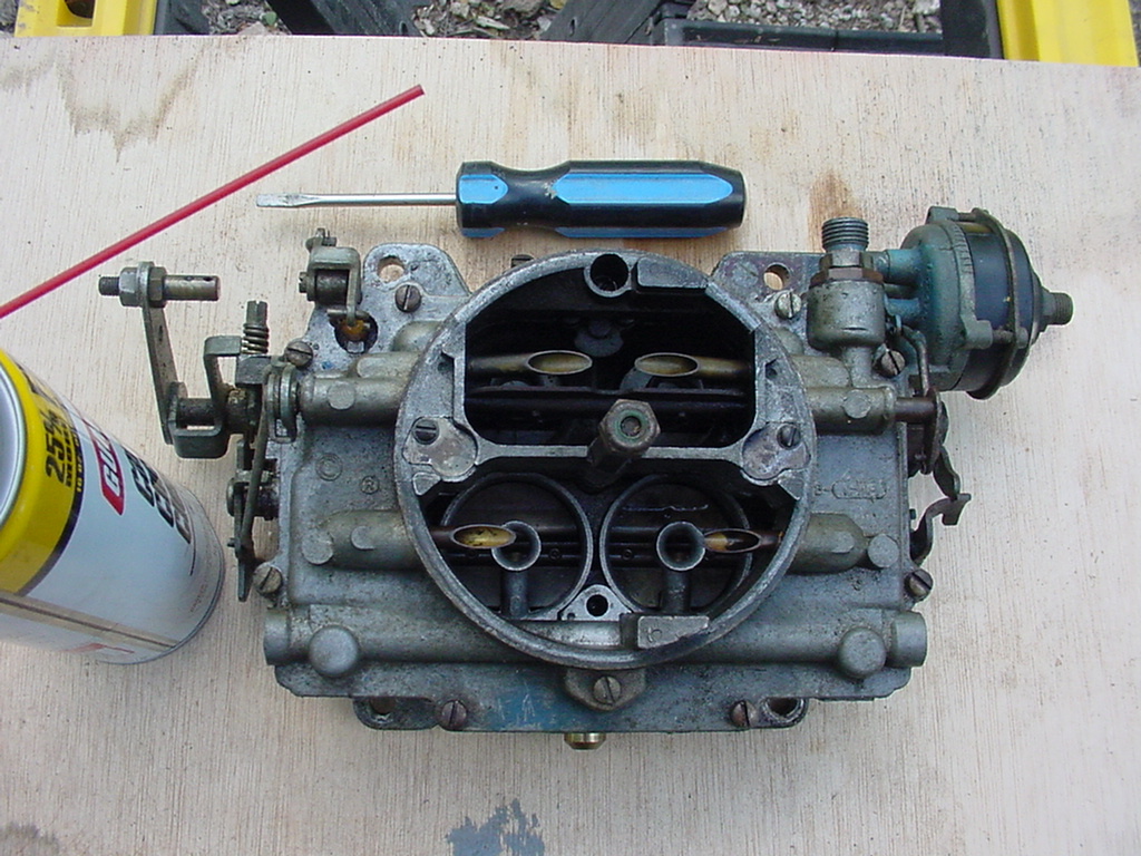

More photos
April 20 2008, 8:42 PM
Once opened up, more dirt was found! This was going to be more than a one can of carb cleaner job!
Upon seeing the sediment I decided I better go for help. Off to the auto parts store for something to soak the carb in. After about an hour of soaking, carb cleaner was used with more success.
Here is my soaking operation under way.
more photos...................next post

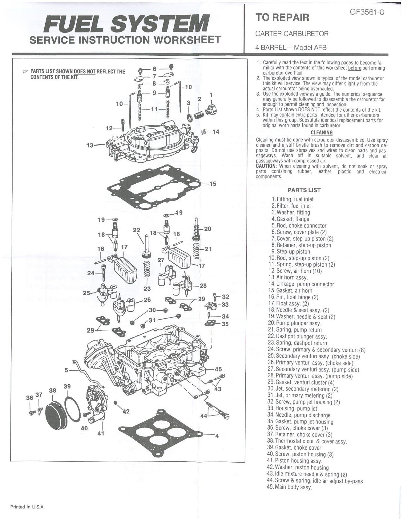

Looked, but didn't see "check valve" on the list of parts
April 21 2008, 7:32 AM
George, I remembered your note, and specifically looked over the parts list for something like a "check valve", and it does not appear on the list.
I think you have some special insider information on this, and I may have to open my carb back up again, which isn't really a problem.

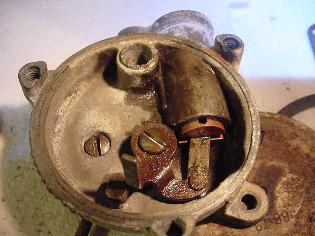

Took apart the thermo choke assembly too
April 21 2008, 8:12 AM
I decided to see what the heat activatd choke assembly looked like inside, and I’ll post the photo images tonight. It’s pretty cool how they got this device to work. There is a copper piston that rides in a bore, and it’s function is to stabilize the lever arm forced by the thermocouple. Odd thing about it, however, that piston doesn’t like dirt and it will seize up if a speck of dirt gets in. I had to work mine a bit while flushing with carb cleaner, but once it was clean inside that bore, it functioned like new. I put a couple drops of Teflon oil on it to keep it sliding.
The design is flawed because the bore is turned up so it gets any dirt that may drop in. Sadly, this is probably THE reason many of these old chokes stopped working. I suspect mine will work fine when it is installed, and I’m anxious to try it out.
With the check valve and chokes, starting the boat will become a new experience.
Regards,
Paul

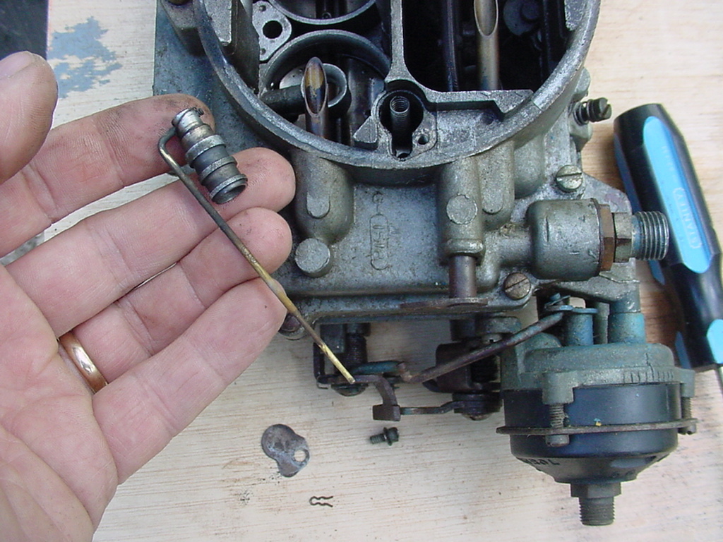

Photo ( Internal choke piston assy )
April 22 2008, 7:37 AM
Here's what the piston assembly looks like, after being freed up with a little carb cleaner and a drop of teflon oil. A little more brushing with a brass gun brush, I'll give this another washdown and lube, and pop it together.
The function of this assy is to have the upward stem seen in the photo work with the heat activated metal coil in the choke housing. WHen that coil starts to tug away at the stem, the piston you see in this photo adds stability to the action and supposedly keeps things from binding, etc. In reality, that piston is facing upward so it can collect dust and pieces of rust. Since this is a very simple device, it may be wise to pop it open now and then and flush things out, drop a little sewing machine oil or teflon oil in there and keep things reliable.

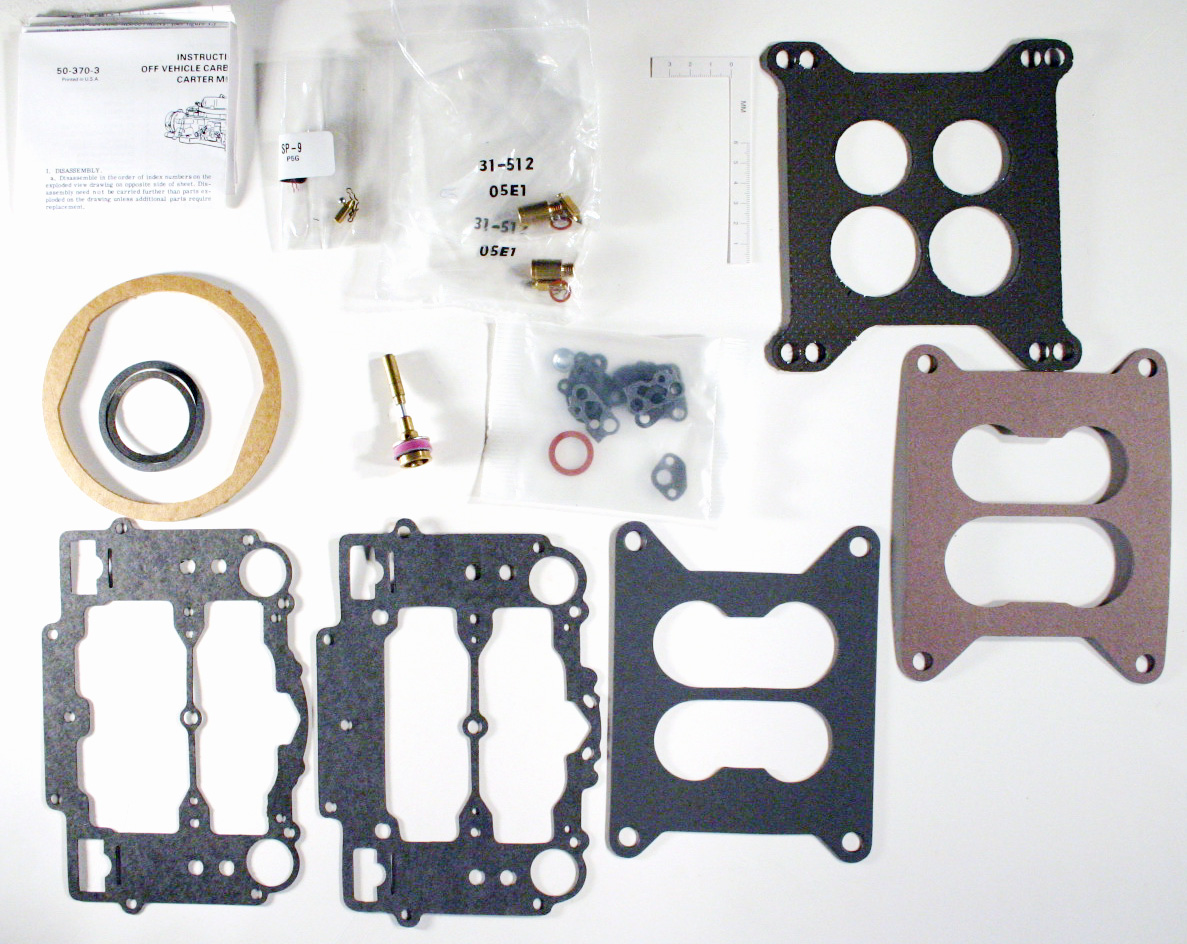

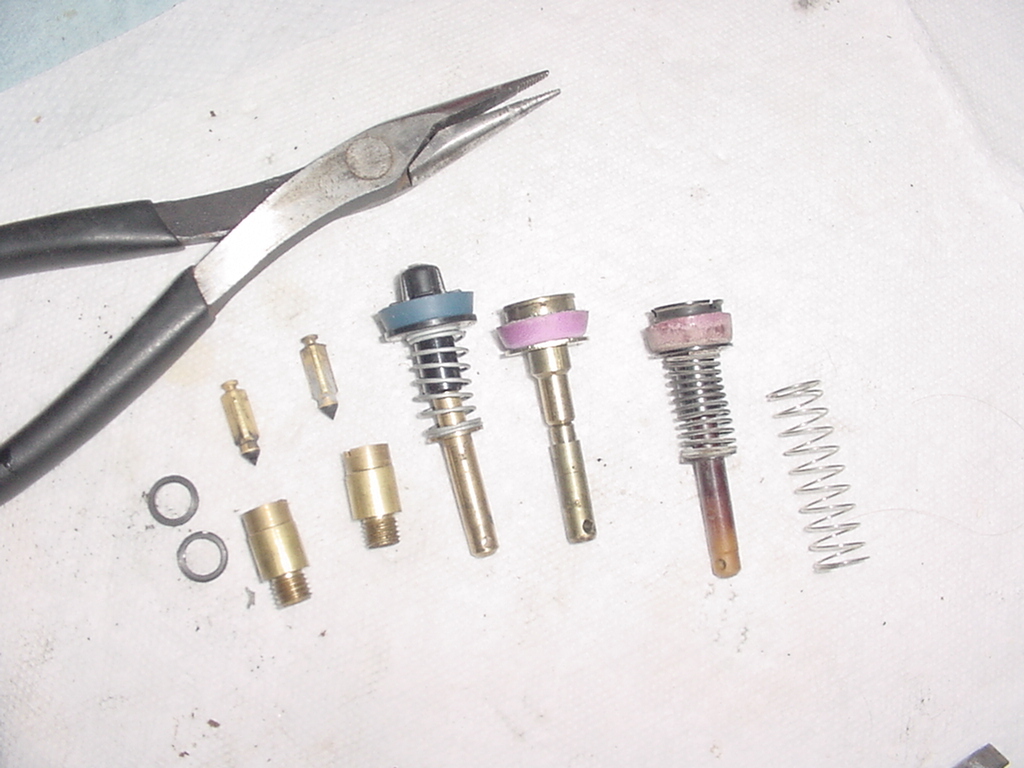

Two styles of accelerator pumps
April 21 2008, 9:17 AM
The accelerator pump and plunger assy that came out of the carb looked like this.
The one that went back in didn't have the spring around the central stem, it relied on a spring underneath. I've seen them looking both ways, wonder why the difference?
In this photo of a Carter AFB rebuild kit, you can see the style of accelerator pump I used. Everything fit nicely, hope it works well.
Paul
This message has been edited by FEfinaticP on Apr 21, 2008 9:21 AM

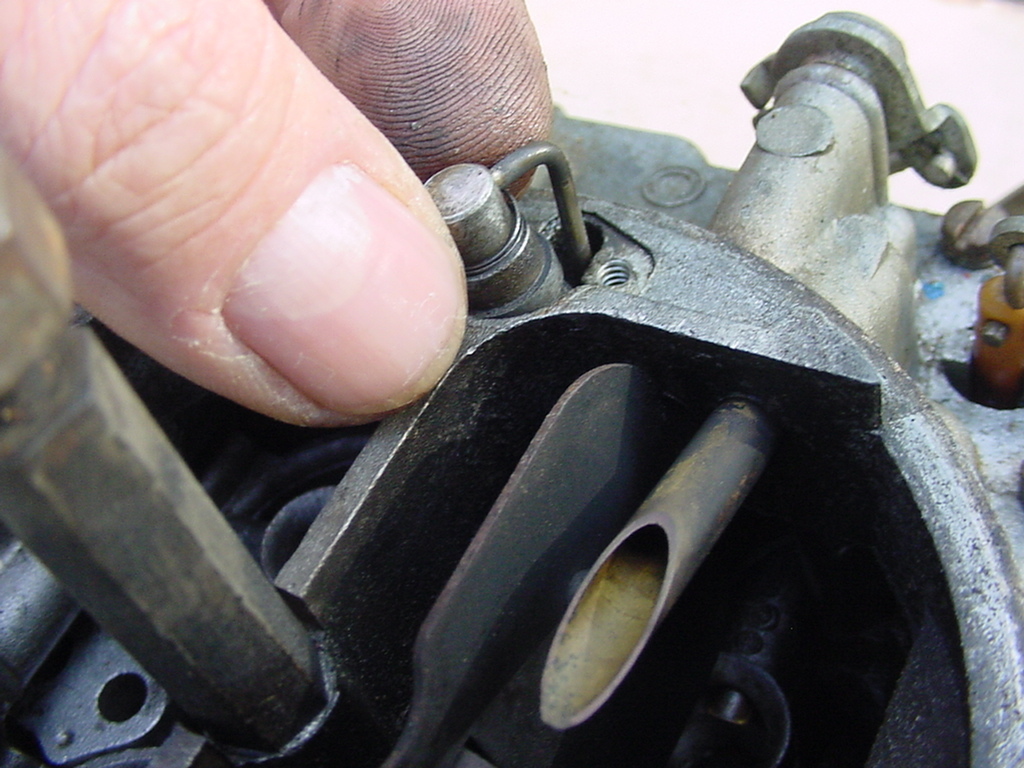

Tim
(no login)
Carb tip
April 21 2008, 7:27 PM
Paul,before you put your carbs on the engine,check the throttle butterfly`s for a "perfect wide open"position.Turn the carb upside down and then rotate the linkage to WOT and check the throttle vavles.They all should be at a 90 degree intersect with the carb base .
I have yet to see a perfect wide open setting on an OEM Chris Craft carb.
Tim
Paul
(no login)
Tip accepted
April 22 2008, 7:19 AM
Just checked the carb and as you noted, they "almost" open all the way.
Paul

Photos ( different types of accelerator pumps )
April 22 2008, 7:42 AM
From my various kits and parts that have come out of carbs, here are three different types of accelerator pumps that are used in the Carter AFB. The one in the center has a two piece rod, which slides up and down. All have the identical fittings and are sized for installation. Time will tell...............
Paul

Which one?
April 27 2008, 7:53 AM
Just curious which type you used.
Tom
Paul
(Premier Login FEfinaticP)
Forum Owner
Re: Which one?
October 17 2008, 4:27 PM
Tom, they all fit, and I use the one next to the old one, that looked closest to the one that came out of the boat. Guess what? It works pretty darn well.
I'll bet you can buy three different kits and find at least two different accelerator pumps.
